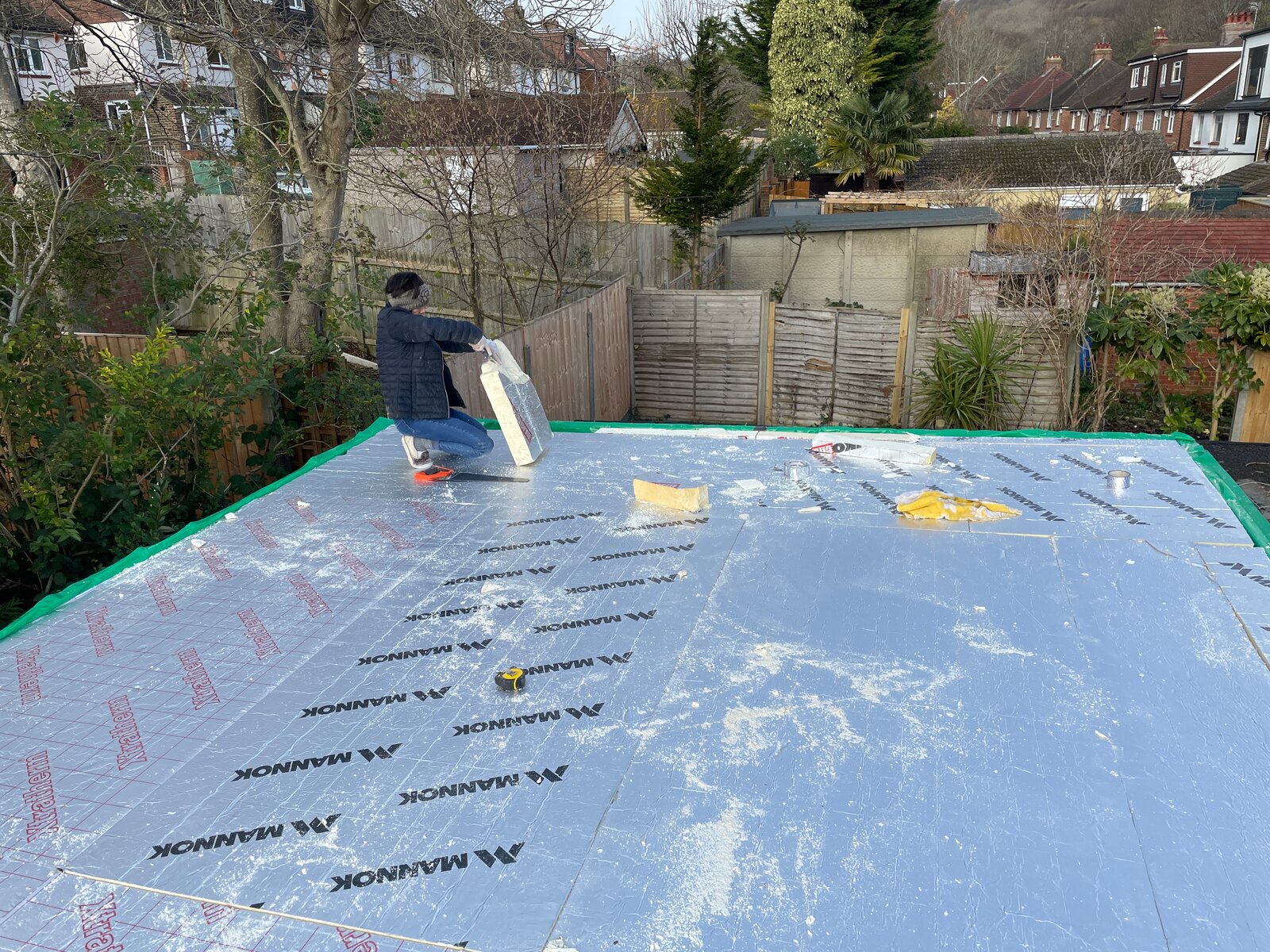

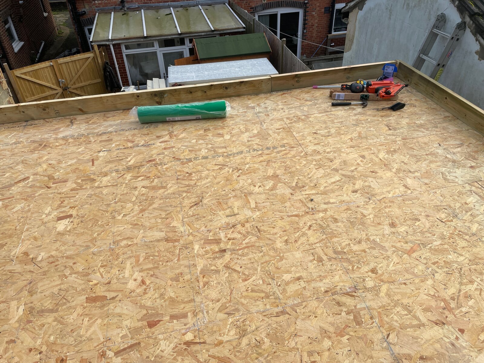

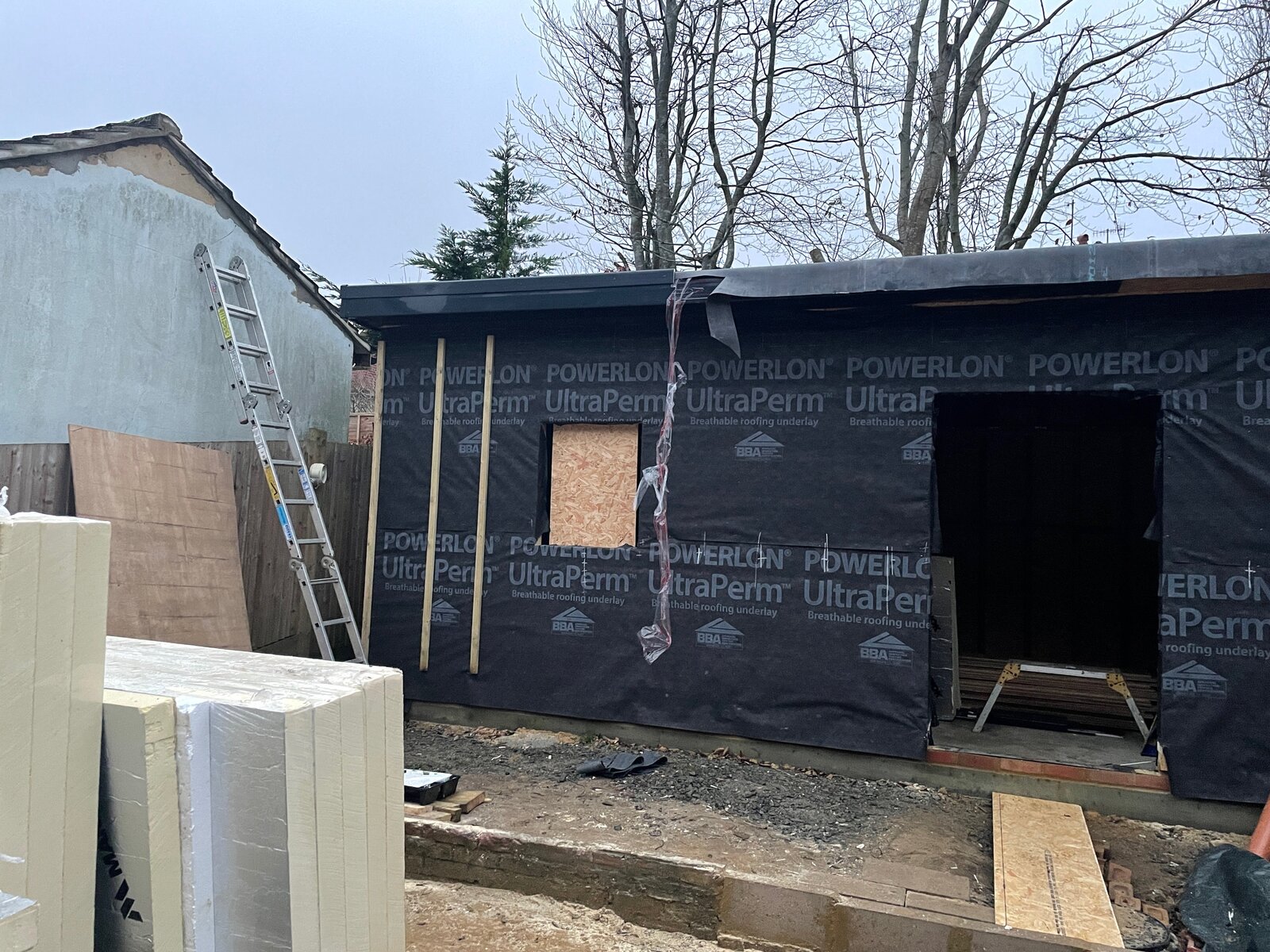

Making a warm roof thinner
Quick update for anyone considering doing this. All seemed to work out ok. couple of pics below showing makeup and last one with half the fascia done. Cant see a downside as yet although may be a problem if you're up against height restrictions as the 'eves' are now 200mm higher that they should be.
