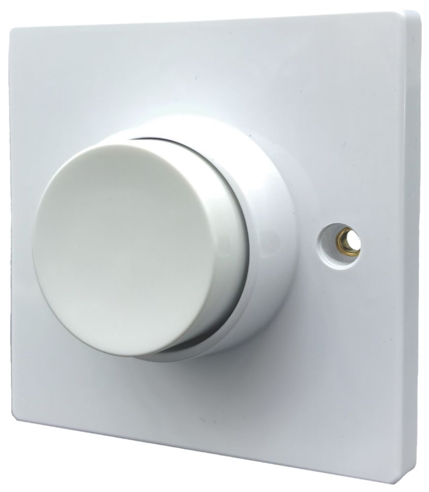

I have not had very much success with humidity control with high humidity, the sensors can get over damp and take ages to dry out, does not matter if simple display or switch, and had the extractor in my dads old shower simply run 24/7 where simply the bedroom was dry but sensor remained damp.
The pneumatic switch
ae235
worked well, set to run to max 10 minutes press on entering shower and press when leaving, simple. Keep it simple.
