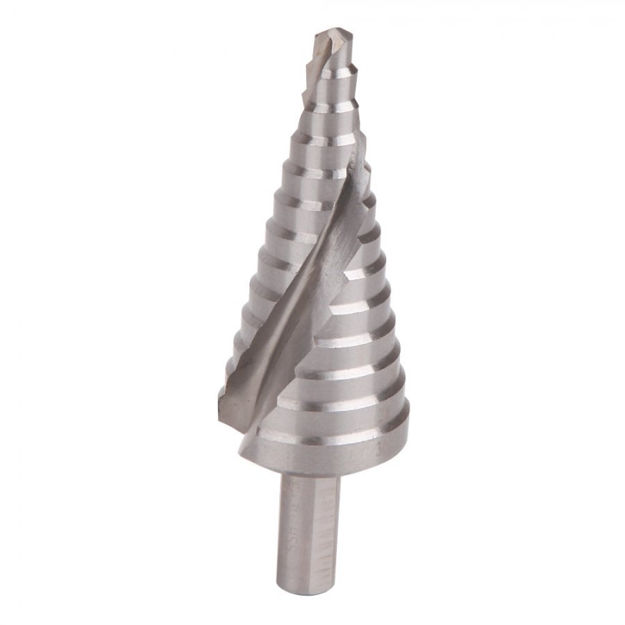

Have any of you got a way of enlarging a 20mm hole in eight sheet metal up to a 28mm , as the hole is already there you cant centre the drill of the hole saw , dont really want to file .

Or a step drill, but one that size is £££

http://www.screwfix.com/p/erbauer-spiral-flute-step-drill-bit-6-30mm/7877d
They also do 6-36mm which I have. They last really well.
You can get some dirt cheap but I don't think they go as big as these do.
Sammy , never seen one of those looks just the job cheers Howy .
