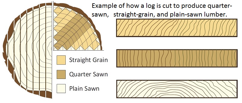

Thanks for that - I may be being a bit slow but what's "quarter sawn"?
Basically most softwood is converted from timber boles (trunks) by sawing "through and through" or what is also called plain sawn. That means that every trunk yield one or two true quarter sawn boards (where the rings run face to face when viewed at the end of the plank - top two examples in the diagram below) with 2 to 4 more boards which will be nearly quarter sawn. True quarter sawing isn't employed much these days and rift sawing (which gives a very stable board) is even less common due to high wastage. To get appropriate boards (i.e. either quarter sawn or straight grained) it will mean trying to get a timber yard to co-operate with you - and that isn't always easy. In trade terms you'd normally have started out with a house-sized stack of T&G flooring and would simply pick-out the best boards for your doors and nailed the rest down as flooring
