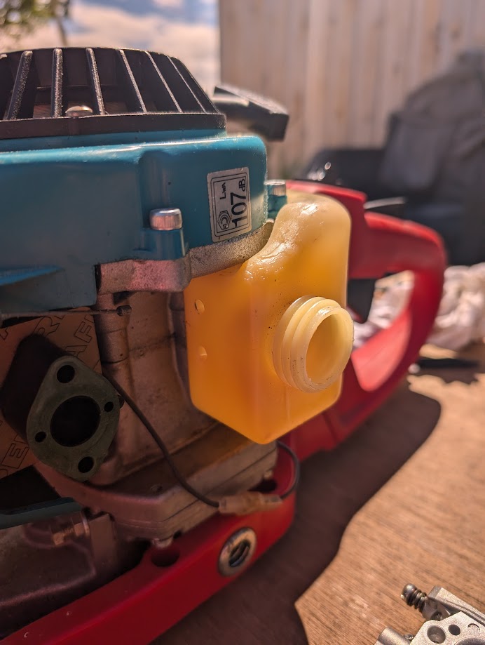

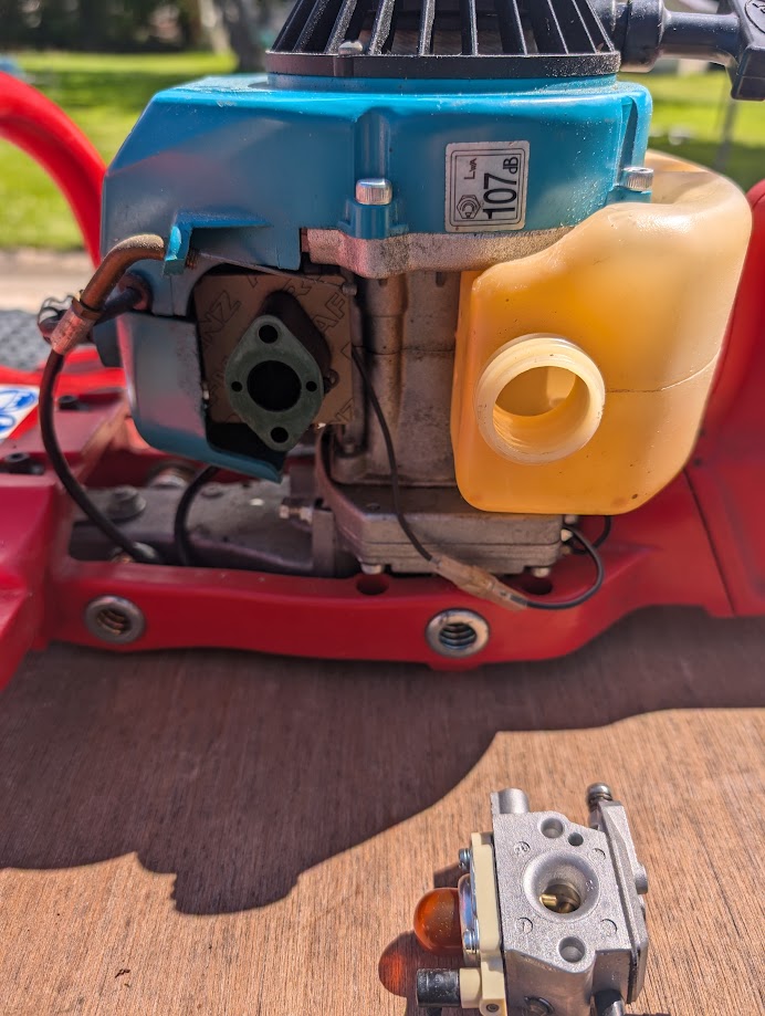

Well it turns out they sent me a length of pipe which is too short so I won't be doing that just yet, looking at it it does seem a bit fiddly trying to get the pipe into the small hole in the fuel tank. Should/can I remove the fuel tank in order to do this?
Also now I have the can of carb cleaner I might as well go ahead and clean the carb, do I remove the black plastic casing in front of it to get at the carb?
Best to remove the fuel tank to fit new pipes really.....I cut the pipe end at an angle to help it pass through the plastic.

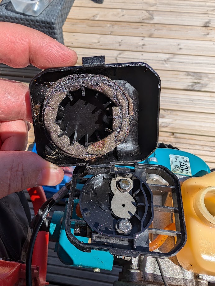

It's not clear how the fuel tank can be removed, I've tried prising it out in all directions but it's solid.

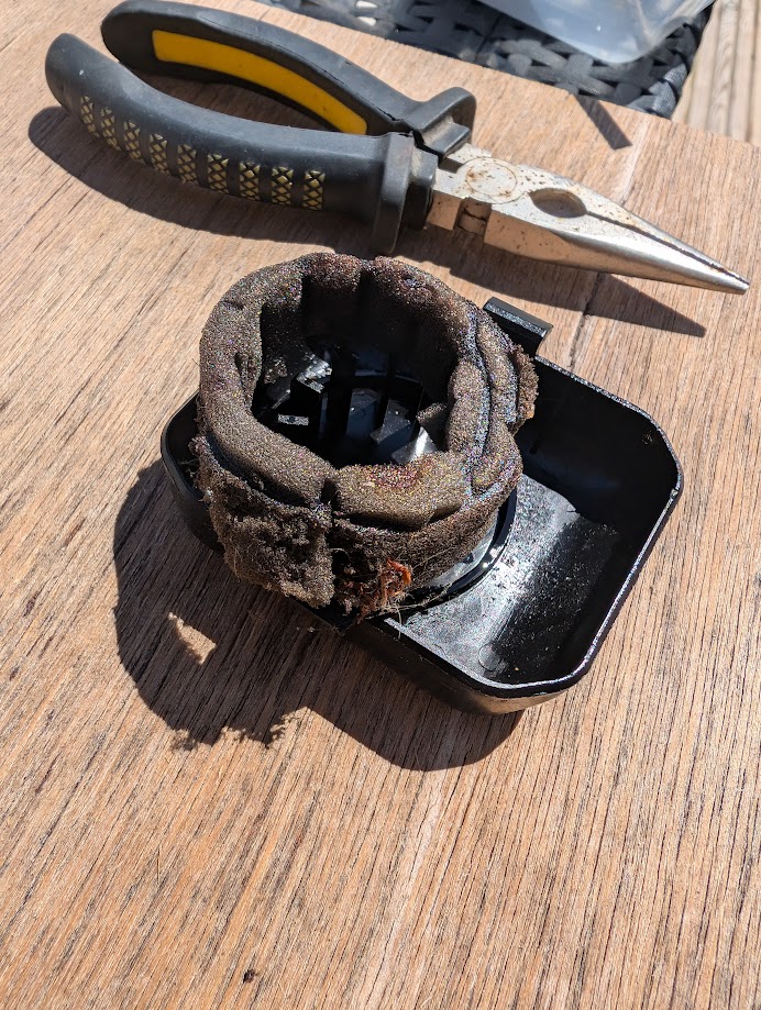

Also the foam filter, (is that the air filter?) is saturated and has perished, I checked on spare parts world but a replacement is no longer available.
Can I just get a generic piece of foam and cut it to suit?
You can use a cutting from foam that is fuel resistant.
The tank may be sandwiched in place between other parts, or maybe held by screws.....one or the other!
John

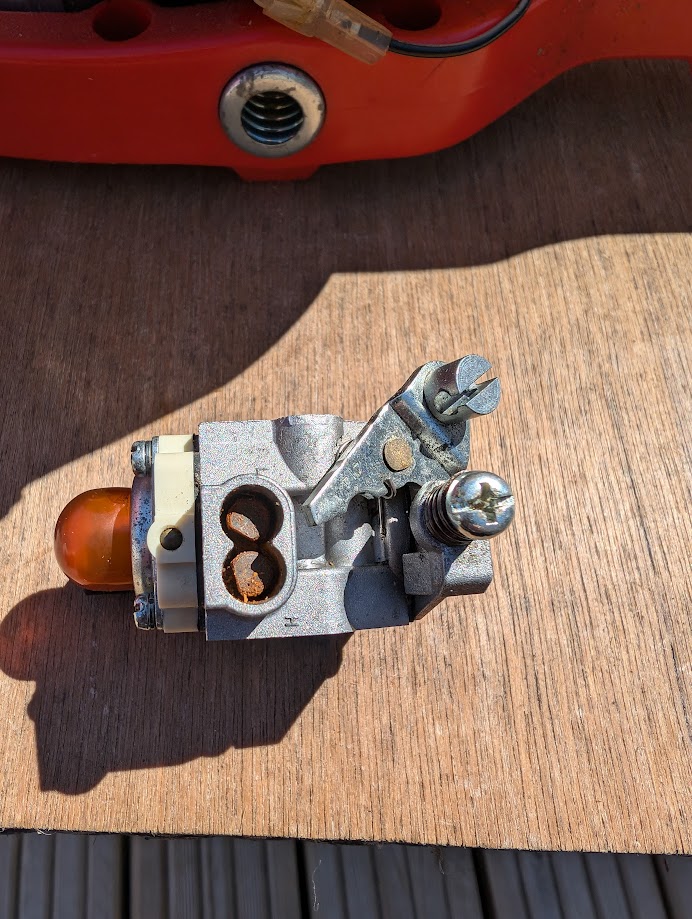

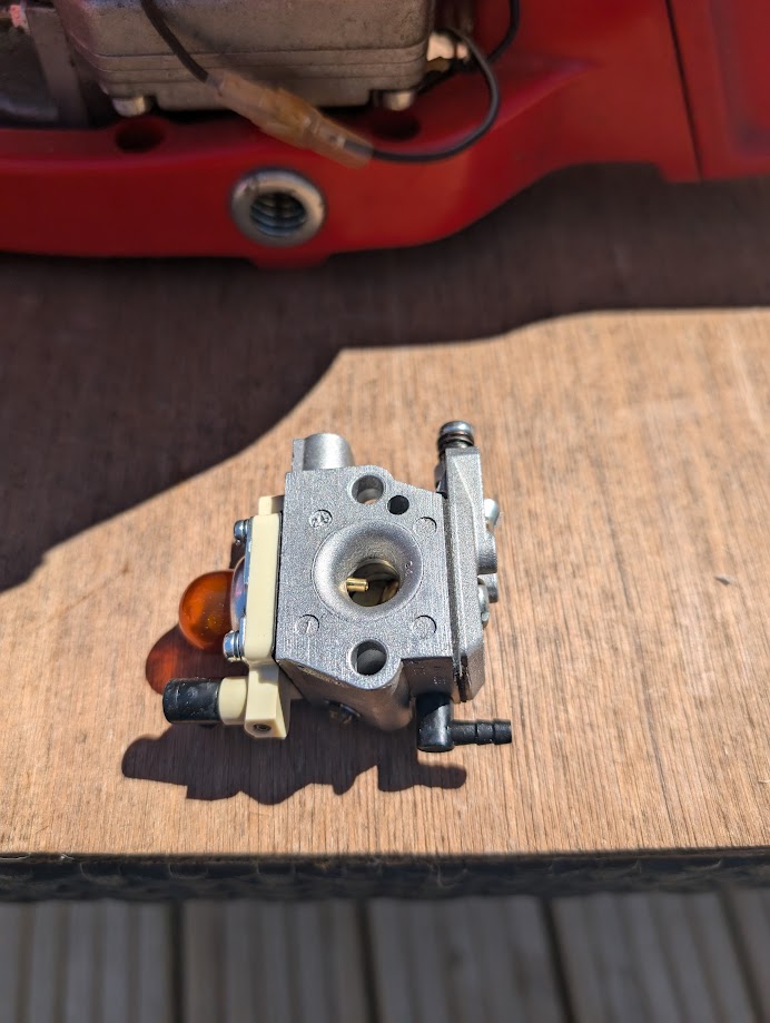

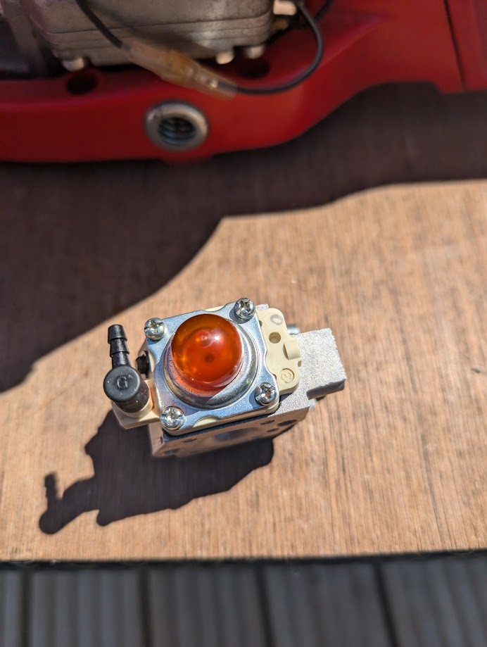

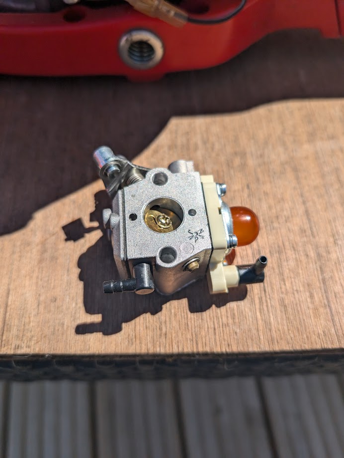

Took off the filter case and carburettor, cleaned the carb, now that it's off it's easier to access the holes in the fuel tank so should be okay.
Just need fuel pipe and filter foam now
I do have the adjustment tools as I needed a pacman type one for my Titan multitool so I bought a set, they look a little rusty should I spray them with WD40?
The air cleaner foam may clean with your carb spray or even washing up liquid - so long as it doesn’t fall apart of course!
I don’t think those screws are the pacman type, rather round with a flat edge but give the tool you have a try.
WD40 won’t do any harm.
The carb looks like a Zama, look for a C1Q stamp and a three digit number somewhere.
