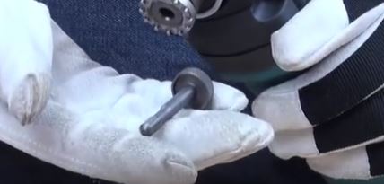

The bolt affair on mine went a bit rusty after being stored in the van over last winter. It's chemically blacked steel, so all I did was clean it up with a bit of steel wool and oil it. Hasn't affected the working at all. Or is it a different part to the piece in this guy's hand?

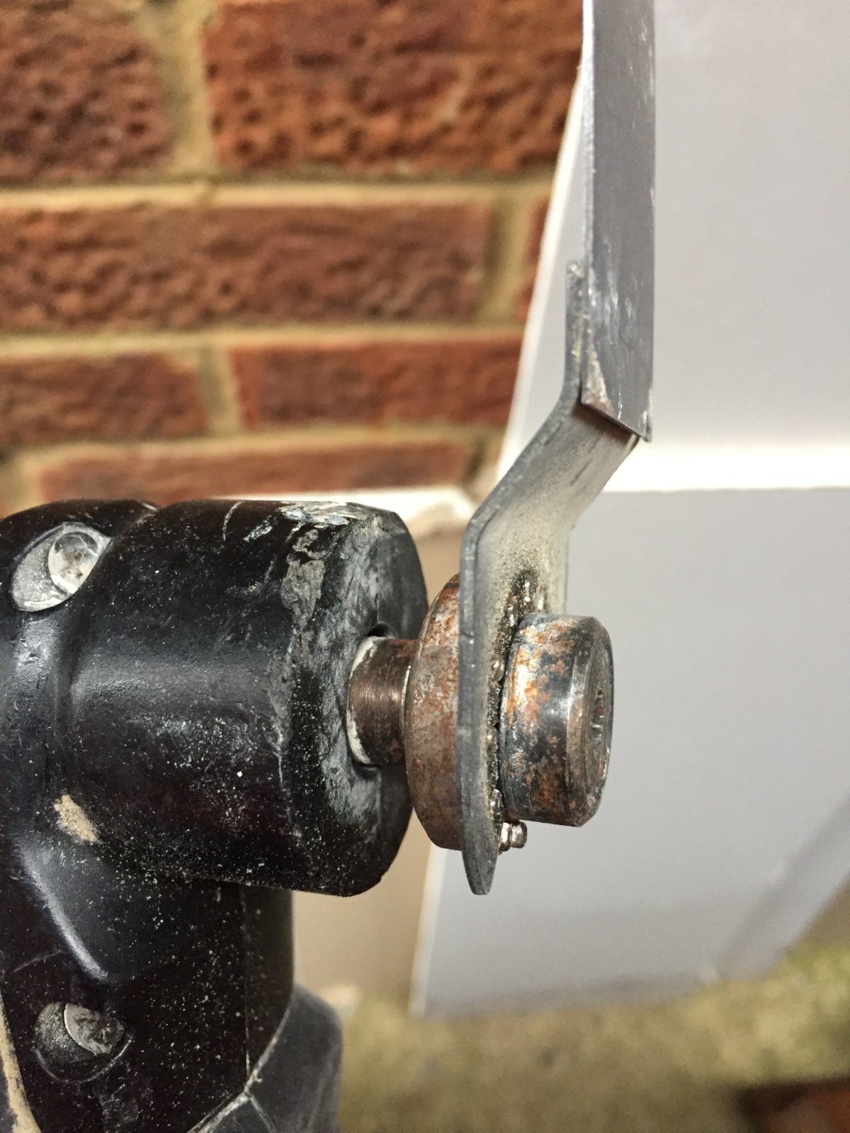

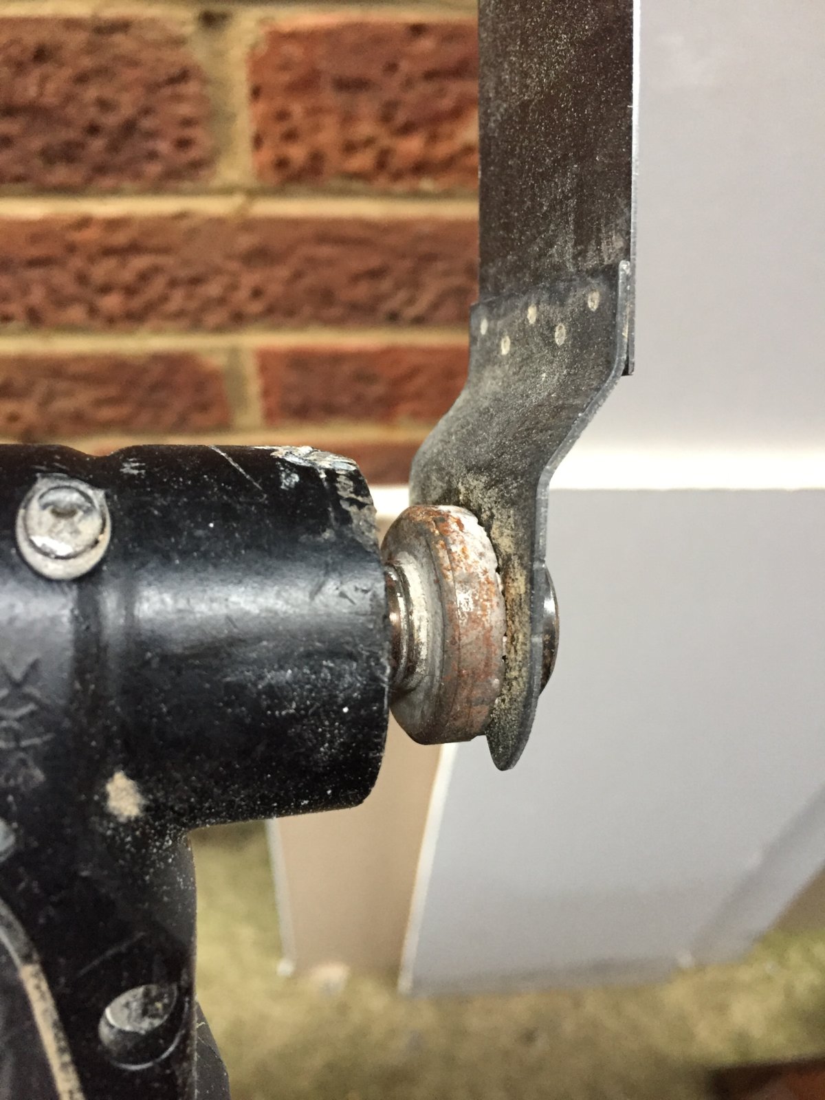

Here’s the rusty part. Should I apply 3 in 1 to all the affected areas?

Take the rust off with a bit of steel wool. or a Brillo pad, or even P120 alox sanding paper first before you oil it
