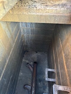

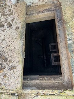

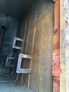

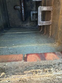

Hi everyone (female here so be kind!). We recently had an extension done and are wanting to do our garden ourselves. My partner is fairly DIY savvy and so is my dad, but no one has any knowledge in sewers etc. The sewer that runs through our garden is a private one (was once owned by South East Water) but then bought somewhen along the way. We are now in the process of doing our garden and are about to dig down to be 2 courses below the DPC of our extension in order to have a patio. However, I wanted to lower the manhole cover level so its flush with the garden. However it looks like below. My thinking is at some point the manhole has been raised as there is what looks like a concrete lintel present one side and fairly newish brickwork. We need it to go down roughly 10cm to be level with what will be the new patio.

We are the 2nd to last it serves. But its definitely privately owned by someone as it doesnt show on Southern or South East water records and to get planning permission we had to pay a lot of money for a CCTV survey to see where it lead too. All we want to do is lower the height.

Second to last implies that someone else's sewage also flows through the mh, it not appearing on their maps is no confirmation of who's responsibility it is.

If you want to make changes to the height of the manhole discuss it with your local BCO ...........
