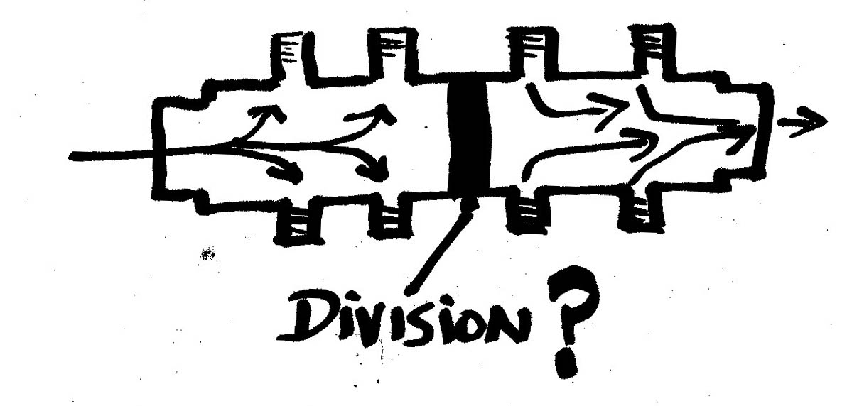

Half of the rads on my 10 rad system are not working and I've turned the system off prior to draining and flushing the 10mm plastic pipes. For the first time ever I have just looked closely the the 28mm manifolds and got very confused !
The are two, red painted, brass 28mm manifolds with 12 ports (4 ports on 3 sides) on each. They are connected together with a T piece. The T piece goes to the Return and the outer ends of the two manifolds go to the FLow from the boiler.
At first sight I couldn't see how it work UNLESS the manifolds have an internal blanking off plate, making each one a 2 x 6 port. Such labelling as there is, appears to conform to that.
But I can find no confirmation from current ads or images on the net that such manifolds exist. So, are there, were there ever, split, single block manifolds out there that explain this ? Thanks..
Your sketch is accurate - such manifolds did exist(y) and are still working . Do the small pipes have compression connections , it looks like they do from your drawing . That was usual too
@nigel & Terry..Thanks for the confirmation. At one stage I started top believe it had been installed by an idi00t and was working out how to rip it all out..It was probably installed 20 years ago and is the first time I've ever had a microbore system and knew nothing much about manifolds. I guess this type is no longer made....and yes they are all compression fitting on the ports (several are leaking, another headache)...So I'm back to checking all the 10mm pipes are clear.. Thanks.
