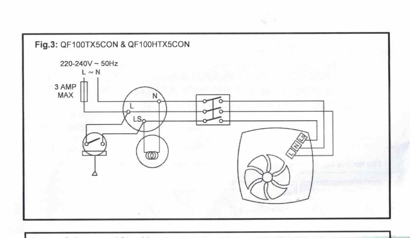

Fitting a new extractor fan model QF100HTX5CON, fan works but not as intended, its being fed from a 3amp fcu as per installation notes.
The wiring diagram for the model shows that for the fan to operate in simple mode off/on - no timer or humidisat the permanent live and live switched must be bridged - ok so far, it does that, so bridge removed to get the humidity/ timer working.
For the humidity/timer to kick in a switched live needs to be provided, so at the fan there is Live, Neutral and Switched live - ok done that.
But regardless of the switch position when the circuit is turned on the fan just runs.
I get it that if the switched live is on when the circuit is turned on from the consumer unit then the fan will run until it hits its humidity target. but the fan just runs with the switch in the off position when the circuit is turned on and can only be turned off at the isolator.
Looking at the wiring diagram there is a coil shown between the neutral and live switched but no mention is made in the notes...See below.
Anybody have any ideas as to what the coil is, tried manrose tech line...just got busy all the time
The coil is the bathroom light!
If you loop perm live to switched live then the fan will run all the time, and any light will be on all the time.
Pls clarify what you want to trigger the fan? Just humidity, or do you want it to run if the light is switched on, and then run on when the light is turned off?
I would say the coil is the bathroom light, the Manrose I have has an over run mine is set to run for 20min after it is switched off. It is adjustable.
In your diagram there is a switched live through the switch and a permanent live to the fan directly through what I assume is the time delay unit (the square with three switches shown)

Ok my conceptual mistake
The switched live isolates the timer / humidity sensor and then the fan runs as a normal fan, as the basic fan mode shows the permanent live linked with the switched live meaning that the humidty/timer is turned off when it gets power, but when power is sent to the SL the fan will still run unless you trip a a switch to cut its permanent live / neutral.
After emailing tech support this is the answer they gave...
Following our conversation today I ask around regarding your query below.
The symbol you are referring to means that the fan can be wired in 2 ways.
  • Permanent live and Neutral and the fan will only come on when it detects humidity.
  • Permanent live, Neutral and Switched live, as above but also can be manually switched with light switch or a remote switch or pull cord.
as mine runs constantly with both timer and humidty both set to the lowest / highest unless the main power is cut I am going to assume faulty unit. bbasically there should be a wake up between the fan being given power and the humidty sensor picking up moisture and starting the fan. Mine just starts straight away.

Disconnect the SL
Set timer to min
Then adjust the humidity to both extremes and see if the fan stops
Humidity sometimes works the opposite to what u expect
Disconnect the SL
Set timer to min
Thank you but been there.. had the thing wired into a plug top on the bench in a room with 40% humidity just starts no matter what the humidity is set to.
Thanks everybody for your help, new unit installed and working straight out the box, seems the one supplied was faulty...the new one had a sealed box... looks like it was the old swap a duff one for a new one and claim a refund trick but who can tell.
