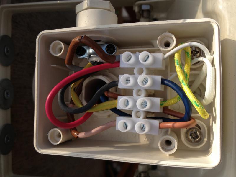

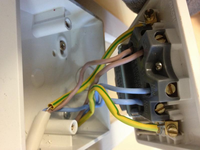

I've just changed the switch for a new one and switched the spur back on. Both lights have now come on without be turning the override switch on and with dawn/ dusk settings more towards night.
I will leave this now like you said for half and hour and hopefully they should go out and then they should go back to normal mode?
Here are the pictures....
Lights have now gone off! Waheeeey!!
But I afraid to try the override switch now lol
Be brave.
You have to try it to make sure it works OK!!
I was just wondering if flipping the switch could trigger the unit into manually on mode, but I can't see that. In order to do that, you'd have to interrupt the live feed, which the override switch doesn't.
Ok chaps, I've tried it with the override switch and it works! Bonus!
Just have to wait and see if the PIRs work now when the light levels drop.
Thank you all for you input and advice, much appreciated! In not as stupid as I look after all

Before I noticed the switch was knackered I also replaced the switched spur also as no power would switch to the outgoing. I think it's just click in general are rubbish
