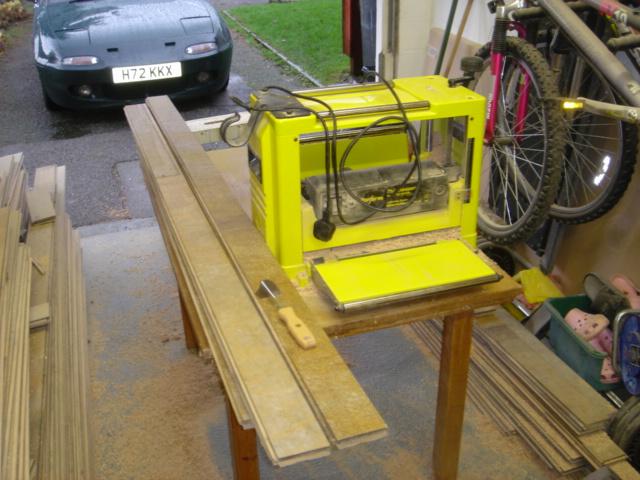

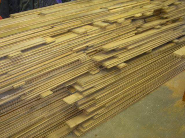

Finally got back onshore to a pleasant surprise, it turns out that the maple flooring i sourced is working out at a volume of 100Sqm instead of the 40Sqm i was told was there! Anyway got a few Sqm's home today and realised theres no way i am sanding this lot down so instead i am going for a thickness machine. Thats the one below, so for anyone interested, in about 2/3 months time i will have 50Sqm of excellent 3 1/4" x 3/4" various lengths of maple flooring for sale and it will have been through the thickness machine to give it a surface ready to lay and seal, the maple flooring is from the 1930's and it looks really nice! P.S Syptoms, thanks again for th advice on laying the flooring and sealing it.

Pants - excellent news! You may remember from an earlier post my use of a planer/thicknesser on my maple stuff, it'll do the job well. Word of warning ... get all the old cleats out before you run the stuff throught the machine as one missed nail will ruin the cutting knives. Cleats in reclaimed flooring sometimes break-off so they aren't obvious to a visual search, so get a 'nail finding wand' (a type of metal detector designed for wood machining) ... Axminster Tools do one - not very expensive.

So far i have cleaned the edges and ran about 35sqm through the thicknesser(huge job)! This batch is now sitting in the house aclimatising for about 2 months before i start to lay it.

It comes through really well. I will still be hiring a belt and corner sander once the floor is laid. The reason is that the flooring i am using has a few rough bits on it which have nicked the blades and a few nails as well. So i don't have the perfect finish. Don't get me wrong the transformation from reclaimed old tatty varnished floor to new look is phenomenal! Also the floor once laid will have to pass my bare foot test for flatness so the belt sander will be needed. The machine runs at 8 metres per minute. I was doing about 7 Sqm per day and that was starting a 09.00 and finishing at 16.00 so it is a lot of work. Sorry no photos as i am offshore again.

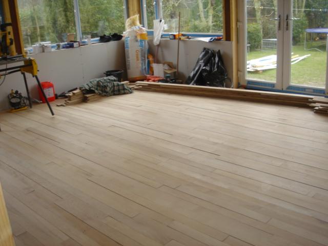

I have finally got to a stage where i can post agian on my floor. Last time i was home i laid 30+sqm in the new extension. I really hope my bletherings below will help someone out down the road. First of all, Axminster tools thicknesser machine(yellow one hobbyist level) is only good for about 60Sqm of flooring through it. The motor burnt out and i had to buy another one(next level up and about £140 i think). I was taking about 1-2mm off in total. It did vary as i was not going for a set finished height but instead removing the old surface to a clean finish and for whatever reason my batch of maple had 2 heights within it with a difference of approx 1mm between the 2 sizes.

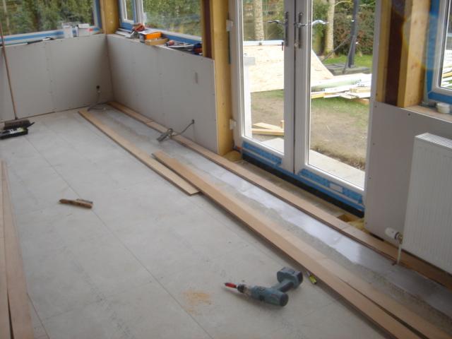

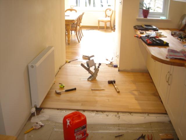

After seeking advice on this site i was unsure how to proceed with laying as i was laying the maple onto caberfloor via the secret nailing method and this is largely judged to be a no no as the design of the secret nail is not really sharp and piercing, more wedge like and this can and will blow the back of the caberfloor out. After a bit of thinking i went down the route of marking the placement of
all my subfloor joists in black marker on the caberfloor. I then applied a coat of pva glue to the caberfloor and laid the maple floor secret nailing through to the joists and on occassion just through the caberfloor. The majority of the time the nail took but on a few hits i could feel the floor blow out, no big deal but i now agree with the people who gave me advice and would not rely on secret nails holding over the longterm onto chipboard flooring on their own.
Once laid i then had the problem of the height difference of the flooring to contend with. This turned out to be no problem once i had spent a few hours running from 80 grit down to 120grit on a hired belt sander. I went even more anal than the bare foot test and ended up crawling around on my gel knee pads feeling for differences(yeah i know, i have a wrongness in my head). I then used an orbital edging sander on any bits i did not feel were perfect. To give you an idea of how good the belt sander was i hired it at 13.00hrs and had it back to the hire shop at 09.00 the next day and that was 30sqm of differing height flooring flattened to smooth and goodness me isn't the belt letting go on the sander when worn quite an event?

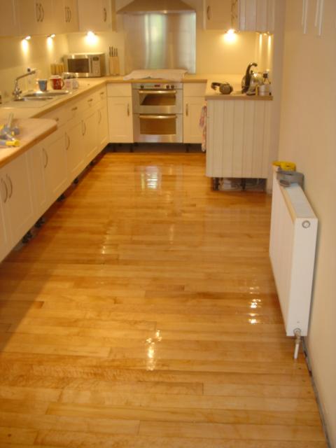

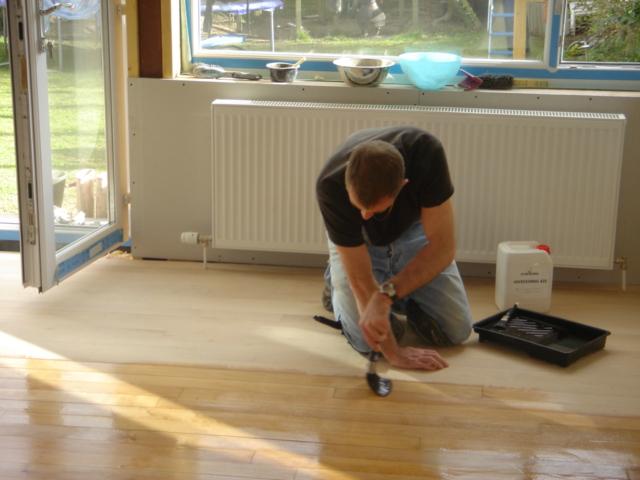

I ended up going for Junkers acid cataysed floor lacquer, there are 2 types, semi gloss and silk matt. I went for the silk matt and bought 2 of 5ltr tubs from decorating direct along with a couple of 4" harris brushes to apply. 1st coat went on stunning and i could see the potential. Sadly someone in the Junkers factory did not know the difference tween semigloss and silk matt when mine was labelled so the second batch was not silk matt but semi gloss although it was labelled silk matt. My goodness me how i freaked out at that!
In the end Junkers were cool&convinced and they sent me another FOC. So that's where i am now, next time i get onshore(15th May) i will lightly sand to key the flooring and then apply the final coat.

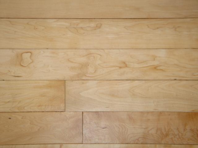

Now i have seen the difference tween semi gloss and silk matt(unintentionally though it may be) i can say that i would go for silk matt every time. It still has a mellow shine to it which compliments the infinite grain patterns of the maple(going off on one am i not). I thought the semi gloss was too 'bright' and concealed through reflection of light a lot of what is going on in the flooring.
I can honestly say that the work needed to turn this flooring from a pile of potential firelighters i bought off a mate to what it is now has been vastly more than i expected BUT i can also say i don't regret a minute of it and it is simply THE most stunning floor i have ever seen(i was not joking about the infinte grain patterns you know). Once i have finished the final coat i will take and post a few pics.

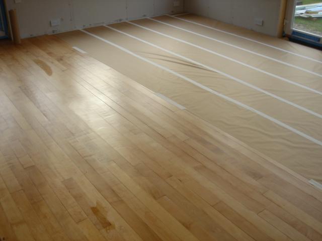

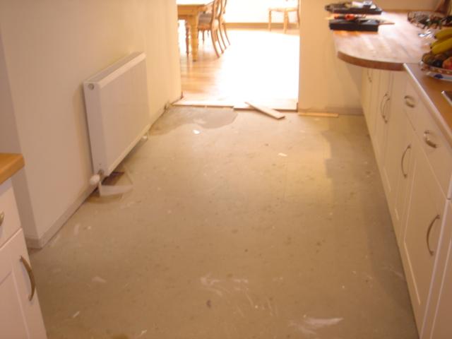

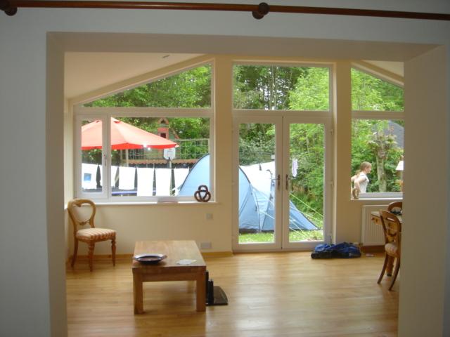

Well, its been a while but heres the photo's(hopefully).
The jobs not done yet. I floored the room off the extension last time i was at home and sometime soon i will use about 30sqm to do the hall. At the end of all this work(and more to come) i am so very very happy i took the time to do it correctly. The kitchen floor shots are with wet lacquer so thats not the finish. The close up grain pattern shot is more like it except spread over 65sqm seamlessly through 3 interconnected rooms. Well chuffed, thanks for advice given by all in this and other threads. I've got more shots if you want them or if it helps with your own project. Cheers
