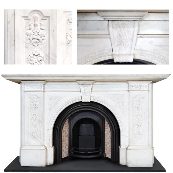

Hoping for some advice. I have a victorian house with original marble fireplace. When I got the house the centre of fireplace where the insert would be was boarded over. Upon removing this i found that at some point in the history of the house someone has removed the insert to leave grotty brick and crumbling plaster behind.
Ideally i'd like to put a new cast iron insert into the fireplace to restore it but as the fireplace is an arch and the inserts are square i can't see how to do this without removing the fireplace from the wall and then putting back.
Apparently moving a fireplace of this age is risky. Is there any tips or suggestions as to how i can get a new insert without damaging the fire surround.
Sorry i maybe wasn't clear. I have the surround which is in place. See pic below. I want to somehow get a cast iron insert into the marble fireplace.
I'm not to fussed about operation- obviously i'd prefer it functioned but if that is a stretch too far and its purely decorative i'd settle for that
WHat you have isn't original, so stick what you like into the original rectangular-ish hole. A fairly simple cast iron basket or something. Paint the rest black.
Victorians had things like this, but they would have graced rather fine houses. Is yours one of those?

I may be very wrong, but I'm afraid I agree with Justin; to me the surround doesn't quite look right for the location. After reinstating a cast iron fireplace in my Victorian terrace, the brickwork in your picture doesn't look big enough to take a large enough cast iron insert,
You may be able to prove us wrong by lifting the carpet and seeing if there is a concrete bed for a hearth underneath and how big it is :)
The only way to fit a cast iron insert properly will be to remove the surround.
However if you really don't want to, you could get a smaller insert and add tiled panels to the sides, something like:
Or, slightly drastic, but cast iron is cuttable. If you can find an arch that will fit, the rectangle can be cut down with an angle grinder, plasma cutter, or a jigsaw.
A messy job though!
the stone arch surround is modern repro. It is not original. I expect it will come apart into manageable pieces so you can remove it. If you can get it off without damage you could sell it on, or fit it in some other room.

Sorry for my complete ignorance but how can you tell its not in keeping with the house from one small picture. I have 2 marble fireplaces I inherited with the house the other one loos very similar to the one posted by Justin but in a darker marble.
If its not original I might have more scope for trial and error. I'd been told the fireplaces cornicing and window panelling were original and can't be altered due to listed status. I'm now terrified of damaging century old (or more) items. It sits under the carpet on what looks like cement or something and its bonded to a concrete hearth
I have found a cast iron arch which fits but i wondered if cut to size how it would be supported and stick to the unit. Thank you for the tile idea I hadn't considered that.

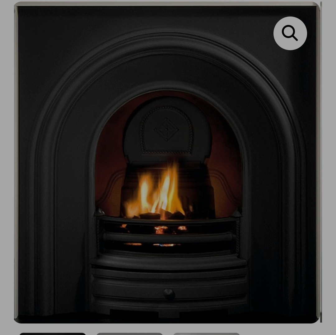

If this insert is bigger than the hole:
https://www.castfireplaces.co.uk/cr...MIz_fo0aW48wIVcfbVCh12iQQlEAQYASABEgKS1vD_BwE
I would get some thin 5mm plyboard and use it as a template.
Cut and sand the edges of the wood down so it fits/slides accuratly into the fireplace hole (I would use a hand powered 'coping saw' or a powered 'jig saw').
[Cut a hand hole in the centre of the template so you can pull it out if it sticks]
Then use this wood tempate to cut the edges off all four sides of the insert so it just slides into the hole. (jig saw with metal blade, metal files).
Slide it into the hole and sercure and fill edge gap with a thin bead of black silicon.
Then put something into the fire grate to stop people starting fires in it on cold nights.
