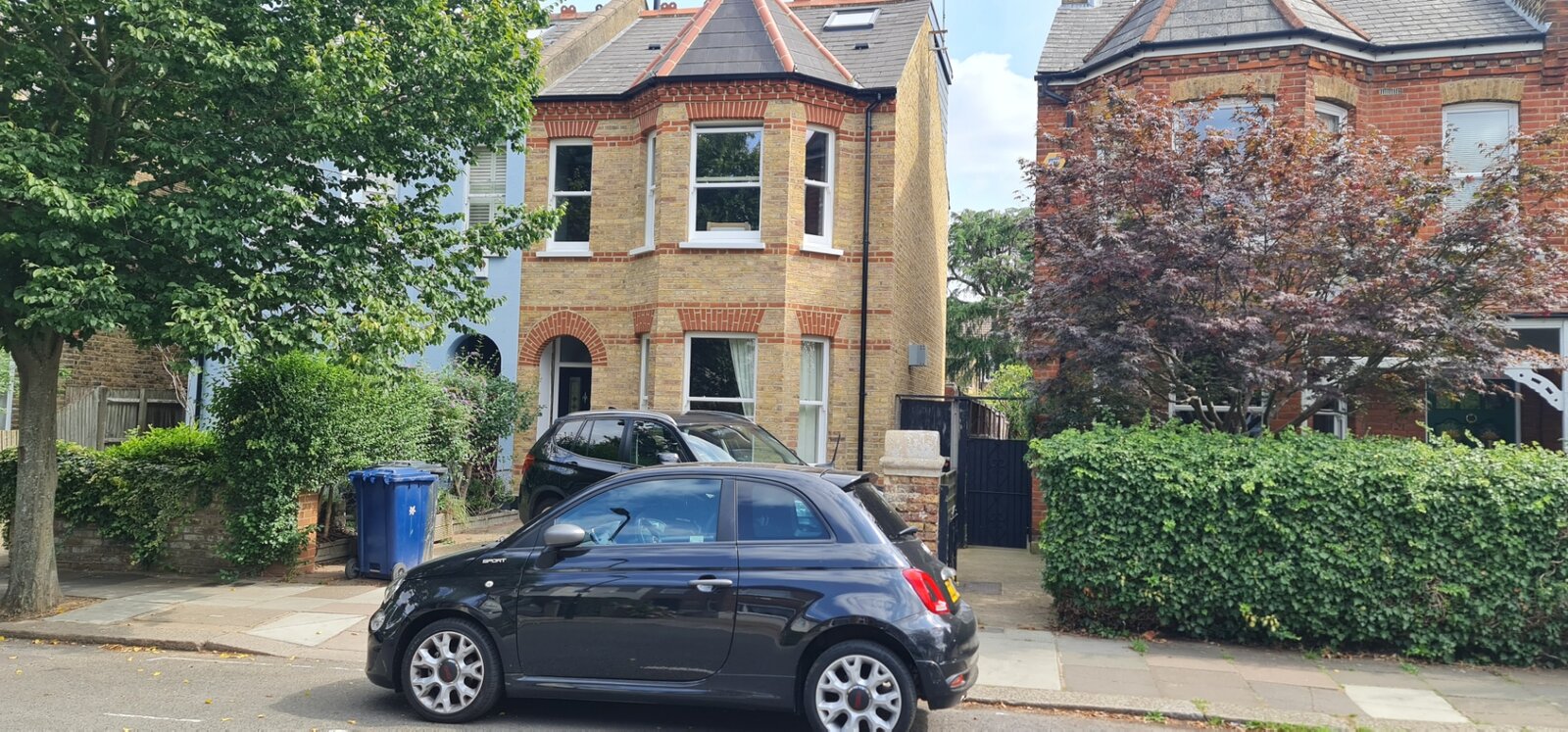

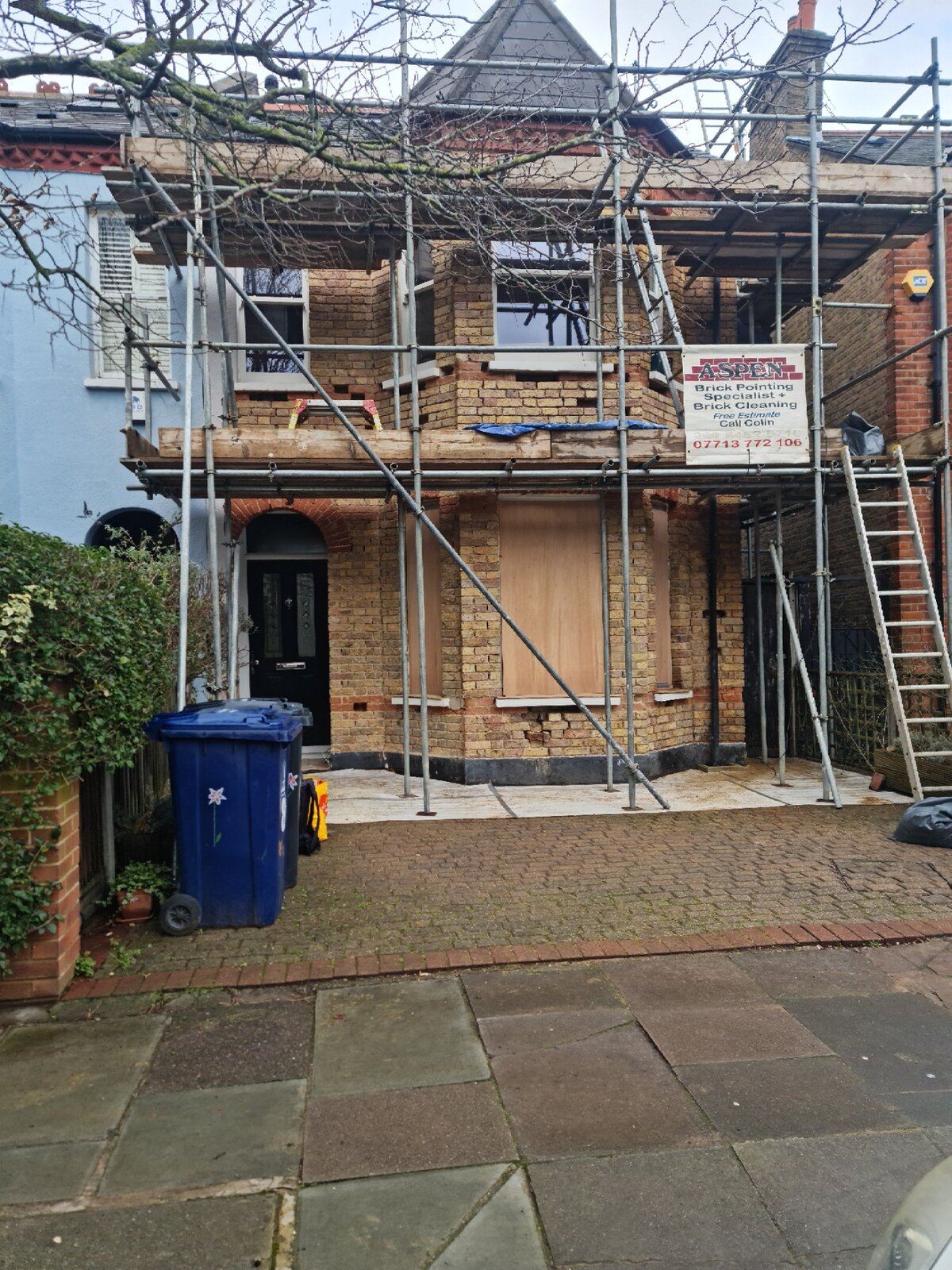

Here is a house in Ealing that had been rendered (same render as the house to the right). He manually hacked away the render- 9" wall, so he couldn't use an SDS chisel.
And this is the house once he finished.
I was there on day 1 to use my Festool tracksaw angle grinder to cut a straight line in between the two properties and then back to paint the front elevation.
