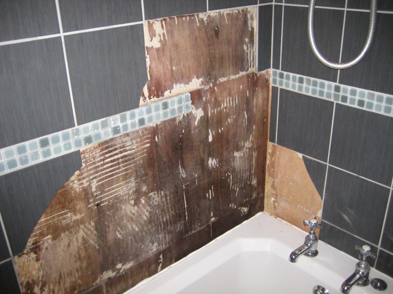

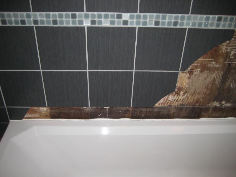

Yesterday I noticed there was a slight leak under by bath/shower. I assumed this was down to a sealant leak, so started removing all silicon sealant from around the bath. I soon noticed some tiles were loose and the grout was cracked. I began removing the loose tiles, the adhesive didn’t stick to the wall at all. It totally came off with the tile and there was mould on the wall.
When the wall was 1st tiled, the stud wall was covered with 18mm WBP ply and tiled straight away. Should I have given it some kind of sealing coat? Also, the wall with the shower was tiled onto plaster (bonding). I took a single tile off this wall and again, the adhesive didn’t stick to the wall at all.
See attached pic. Any advise would be welcome
From the pics it looks as if you used a tub adhesive,tiling onto ply requires a flexi powdered adhesive.
Tiling onto bonding coat is a no no as it wont bond.
Some acrylic primer and tanking fluid would have helped around the shower area.
Does there appear to be any water ingress apart from were the silicone failed,I cant really tell from the pic.
There are water ingress stains and mold around where the grout was cracked. I really need to know why the grout cracked in the 1st place so I can get it right this time, do you have any ideas?

You can use Bal White Star directly onto ply - flexi powdered adhesive is not necessary. Having said that, I would always shy away from fitting ply as a wall substrate prior to tiling.

First off, I would suggest that this is one of the reasons that I always advise tanking around a shower area and especially if you want to use mosaics. You wouldn't usually tank a ply wall.
Due to the mosaics, I think you're gonna end up with the same problem unless you properly waterproof the substrate. You're best off replacing the wall with plasterboard. Tank that and then tile - that'll solve your wall damage problem.
You need to ensure that the floor is firm and doesn't "give" with weight in the bath or this will put extra strain on the silicone seal which could potentially lead to failure.
I'm betting that your silicone seal was sound and the problem was that moisture has gotten to the ply via the grout around the mosaics..... the adhesive has softened and loosened; which has caused the tiles to come loose and the grout to crack. Water has then been running through that cracks and down the back of the tiles.
