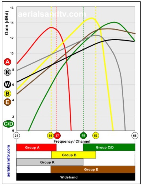

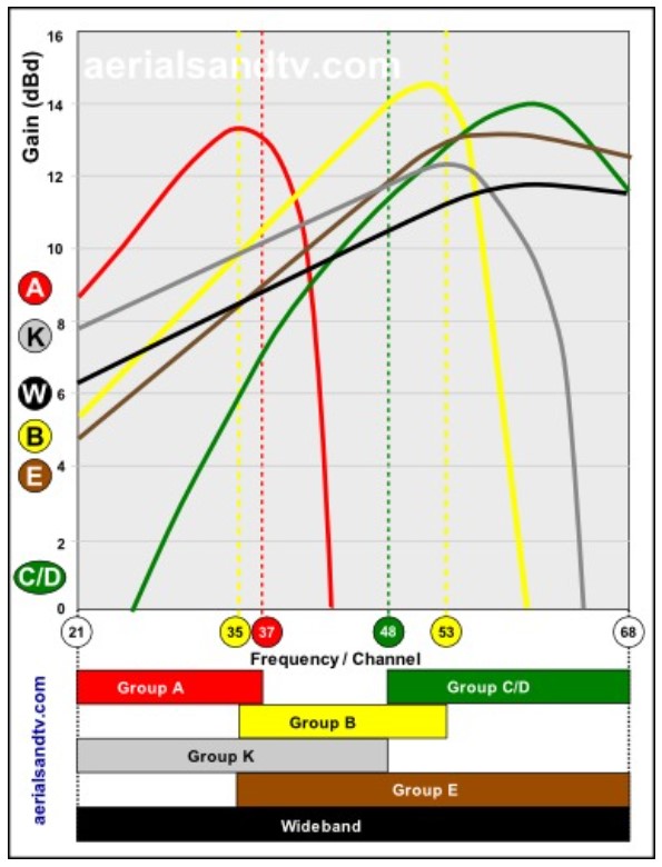

Changing your aerial for a higher-gain model may help, but it has to be the right reception profile to match the frequency distribution of your muxes as they sit now. Ordinary wideband high-gain aerials are becoming less relevant. They have their strongest reception at the upper end of the old ch21-68 range. A big chunk of that has been sold off. Once all the dust settles then the new range will be from RF channel 21 to 49 inclusive.
For most of us who need more gain, a group A or group B aerial will give the strongest signal. Groups C/D, E and wideband are now redundant. Group K will become the new wideband aerial once the Ch55 muxes disappear.
Once you have a better visualisation of what's happening with the various muxes then you can start to make some plans on how best to progress. You can also use the colours on the chart here to check against your current aerial. Older grouped aerials had red or yellow or green end caps on the boom. Old style Widebands still use black. Newer Group Ks will be grey.
