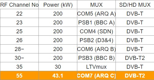

Test the following stations to get all the muxes. Be aware though that some transmitters only broadcast a limited range of muxes referred to as Freeview Lite. Youll notice too that some of tge following are HD channels. The TV you use will need a HD tuner.
BBC 1 (SD) is on BBC A PSB1
ITV 1 (SD) is on D3&4 PSB2
BBC 1 (HD) is on BBC B PSB3
QVC is on SDN COM4
Dave is on ARQ A COM5
QVC Beauty is on ARQ B COM6
Quest HD is on ARQ C COM7 for the time being until the stations are folded in to the other muxes.

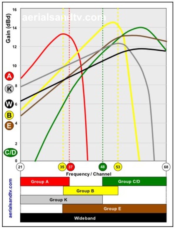

Some of these losses can be offset a little with the right choice of aerial. IFAIK, until very recently Crystal Palace has been classed as a transmitter in the group A band. That meant that its RF channels were bunched in the lower half of the old ch21-68 range. For digital TV that meant the Crystal Palace RF channels used to be between ch22 and ch34. Things changed a bit though because of the need to juggle the other overlapping transmitters because of the sell off for 4G and 5G mobile telecoms. If the info from Wikipedia is correct, CP now broadcasts on the following:
I mentioned Group A transmitters. Aerials matched to Group A transmitters have a red end-cap on the boom. Ordinary Wideband aerials have a black end-cap.
The advantage with a Group aerial is that all the reception power is concentrated in to a narrow band. If you have a look and compare the black line (W) for wideband to the red line (A) for Group A aerials you can see the peak is higher for red whereas it's lower for black. Also, the whole red curve is in the lower half of the graph, so the reception is concentrated there rather than spread all the way across the frequency range.
Something to bear in mind is that these are graph curves for top performing aerials. A Wideband High Gain purchased from a non-specialist supplier may well sit lower on the graph because the aerial has less gain overall.
For Group A aerials their reception range is optimised for ch22 to ch37. That matches well with Crystal Palace except for COM7 on RF ch 55. However, this was only ever intended to be a temporary location. The channels on COM7 were to be folded in to the other muxes. That's still the intention. COM7 on RF ch55 will disappear at some point. You see, the long term plan is to have the TV band go from 21 to 49.
You can get a bit more info on Group aerials and the differences between mediocre and decent aerials at Wideband / grouped TV aerials - A.T.V. Poles, Brackets, Clamps & Aerials (aerialsandtv.com) It's an excellent site and the guys really know what they're doing. The gear they sell isn't available at the usual retail and DIY stores, so it's worth spending some time on their site then purchasing from them if something new is required.
Where the aerial in the loft is an ordinary wideband then changing to a good Group A aerial might help provide a healthier signal before amplification.
