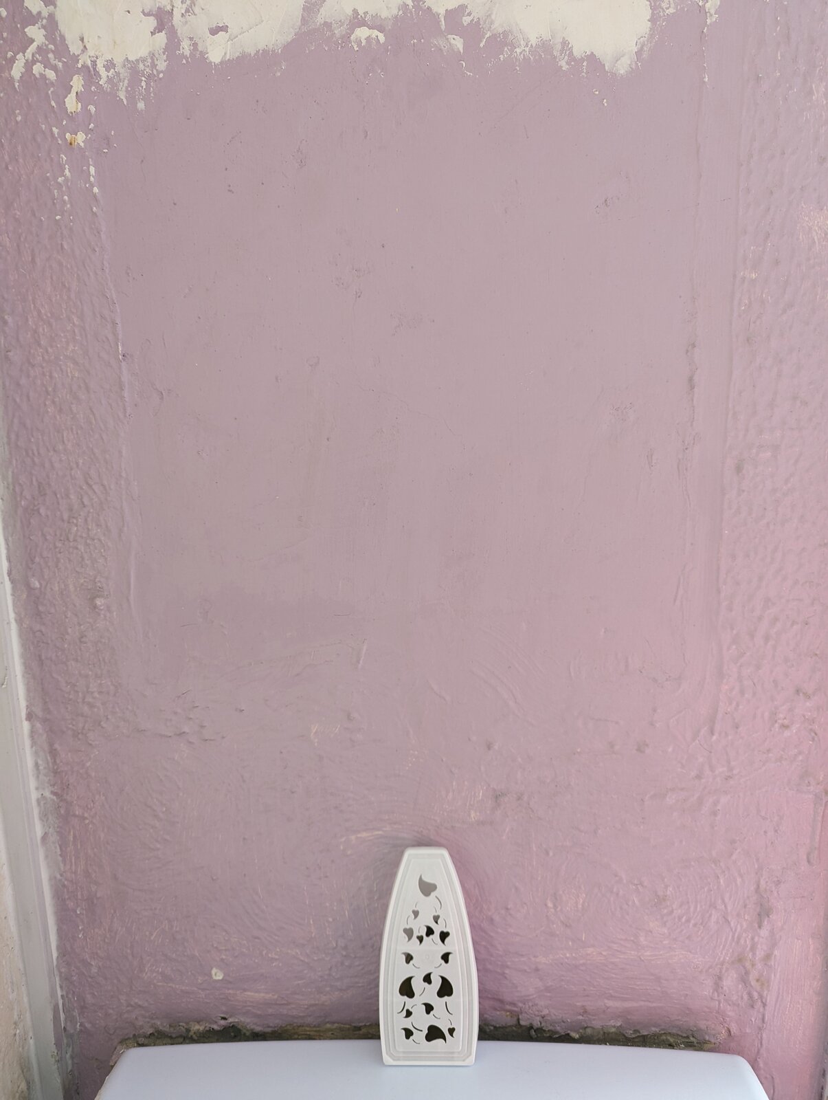

I am doing a few odd jobs for my nan and I am painting the bathroom and doing some boxing in of pipes and she has a patch on the wall where she had the boiler moved when she had central heating installed a few years ago.
I said I will ask here as you are a knowledgeable bunch. Basically what I wanted to know was if someone knows what the pattern is and if I would be able to patch it in and with what product to use please?

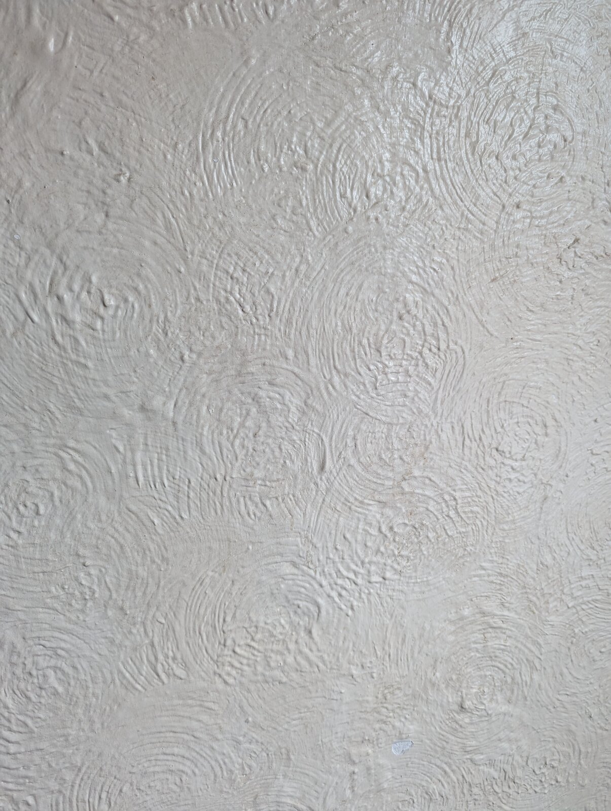

That looks as if it was done with a sponge in a poly bag?
Bit late now, but hacking a hole in artex isn’t the best idea.
Many people would skim the whole thing.

Yeah something like that maybe. I know it's a bad idea to hack at artex. She still has polystyrene ceiling tiles as well!
I think she would just say leave it as it is rather than skimming as she only rents. I don't think the landlord would help. They would just say it's ok as it is.
I was just hoping there was a solution. Hopefully with a fresh coat of paint it will help a bit.

DIY job with DIY store 6 Inch ish stipple pad spun around to make a swirl.
Looks like it's had 2 layers or first effort dried quick because wall was not sealed. I can see two pattern layers of swirl.

Yeah apparently it was done without a stipple brush but I don't know how or what method. I have bought a stipple brush to have a go at getting as close to the pattern as possible.
You spin and remove at the same time. If you spin and then remove you are left with rectangle spikes. Try not to do that. Custard consistency mix. Use easyfill or box of powder filler Vs artex. Seen the price of that stuff? Good grief..

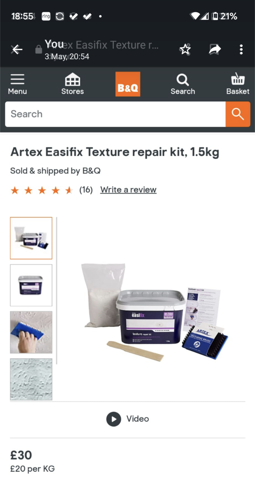

Yeah shocking price. I bought a kit for £30 that is supposed to do upto 3m² and it was well reviewed so hopefully it is worth it. The brush was £15+ anyway.

I patch artex with easyfill powder mostly. Smaller area I use decorating filler. Only use artex powder for larger areas as it takes hours to set vs the others I mentioned
