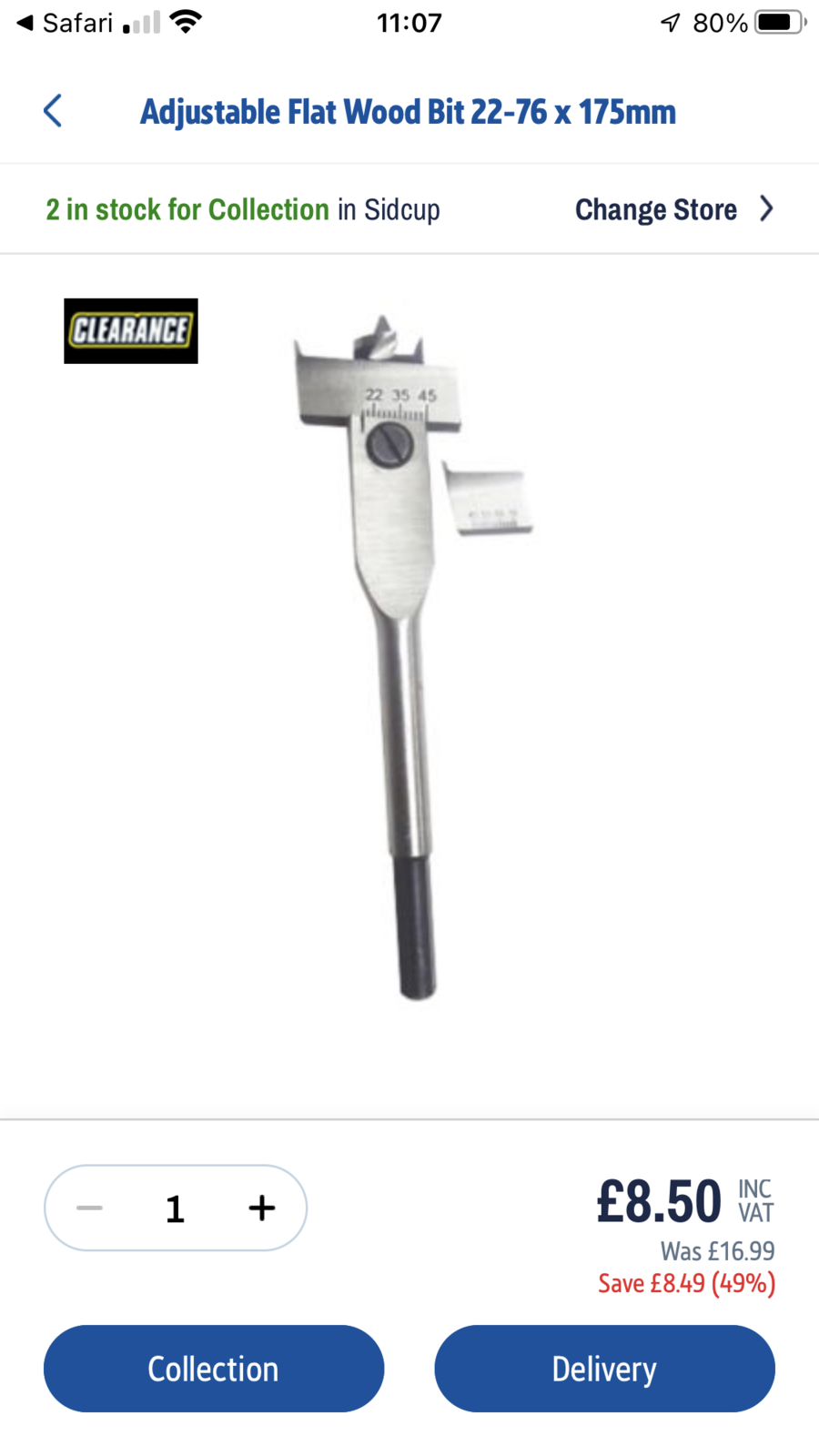

Have used these in drill for large diameter holes .
