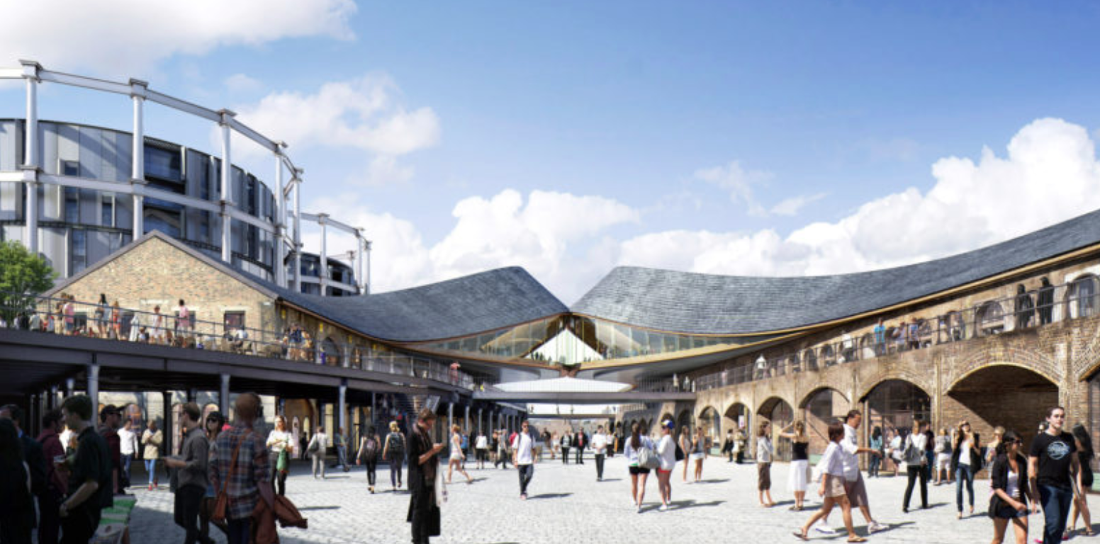

Another but more wacky one is to consider a hyperbolic paraboloid roof!
is that this one?

is that this one?
