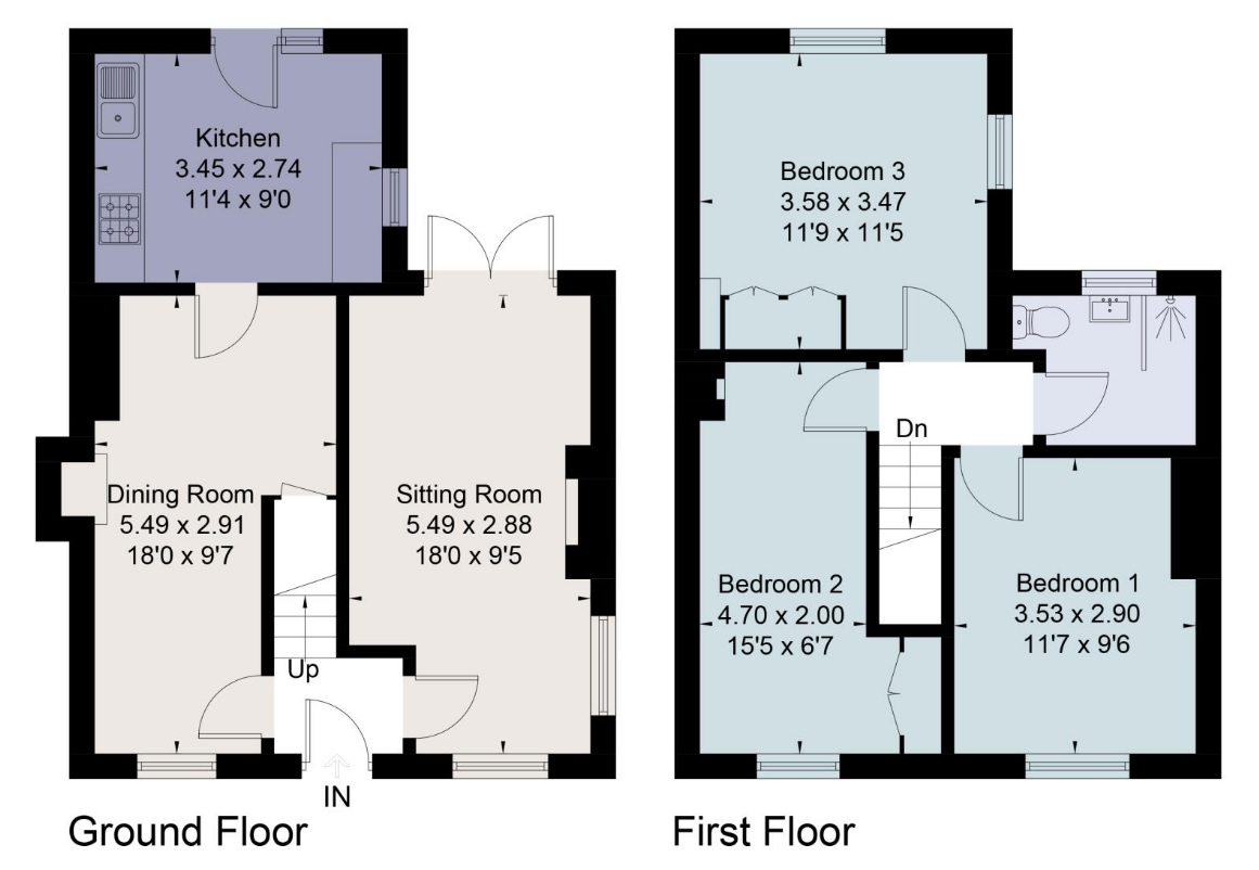

Maximum extension under PD for this plan

Dear All,
I was thinking of extending this rear wards 2 storey or single storey but don't think it's straight forwards. Boundary to the right is on the line and the left is 1m, detached property.
Garden is over 100ft. Would appreciate your thoughts and any sketches on the attached.
Many Thanks!
I think for a single story rear permitted development extension on a detached house you are limited to 4m (unless you apply for prior approval).
If you go to two stories I believe the limit is 3m for the whole extension.
I'm pretty sure you can extend behind the kitchen, but I'm unsure if you can make full use of the space behind the sitting room. It may depend on whether the sitting room wall is classified as a rear elevation, or whether that area is a side elevation.
The technical guidance on this is a bit confusing - https://www.gov.uk/government/publi...class-a-enlargement-improvement-or-alteration
thank you! I sort of feared exactly what you mentioned. Currently the house is rather tight and difficult to extend.
Can that L bit infill be a side extension or is that not permitted?

I am thinking of putting an offer on it and property is in an area where you cannot change the brick work. So trying to figure the worst case scenario
for PD thats a side extension so you can only extend back one storey 2.74m
Does this mean I can go back off the kitchen width at 4m depth and off the side of the kitchen behind the lounge till it meets the main side wall ( all single story?)
