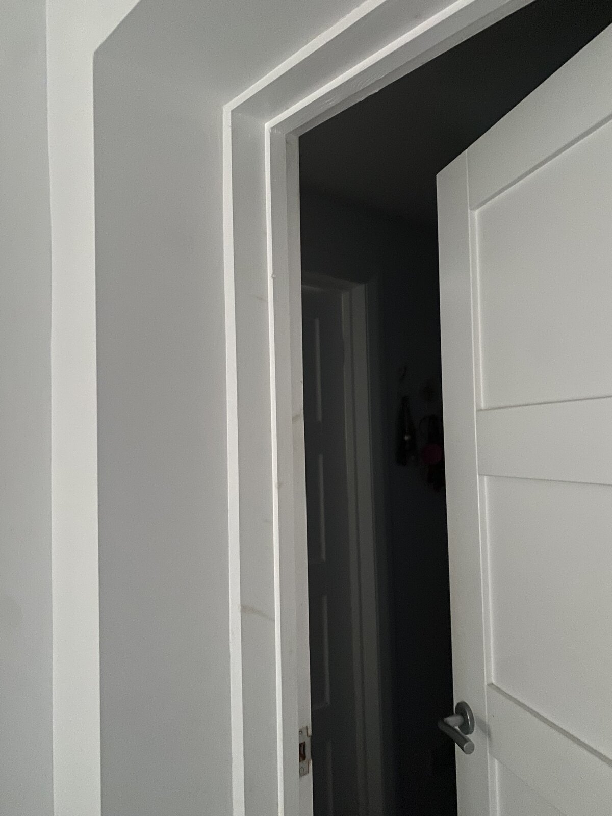

Why do you need to line the full wall thickness?
I've never known the full wall thickness to not be lined. It would look odd wouldn't it any other way?
I’ve hardly ever seen the full width lined. Surely this is what’s normally done (pic)
So, that wall is plaster skimmed for the most part and then lined for the smaller part? Or is it skimmed the entire length and then lining put on top?
If you have the width tolerance, then it is better to dab boards onto the wall, get it nice and flat and upright, then fix the casing onto the boards. Skim it later.
Fire rated casings are fixed the same. You just need to ensure you have the correct door fitting gap (top sides etc) and all the smoke/fire seals in place.
