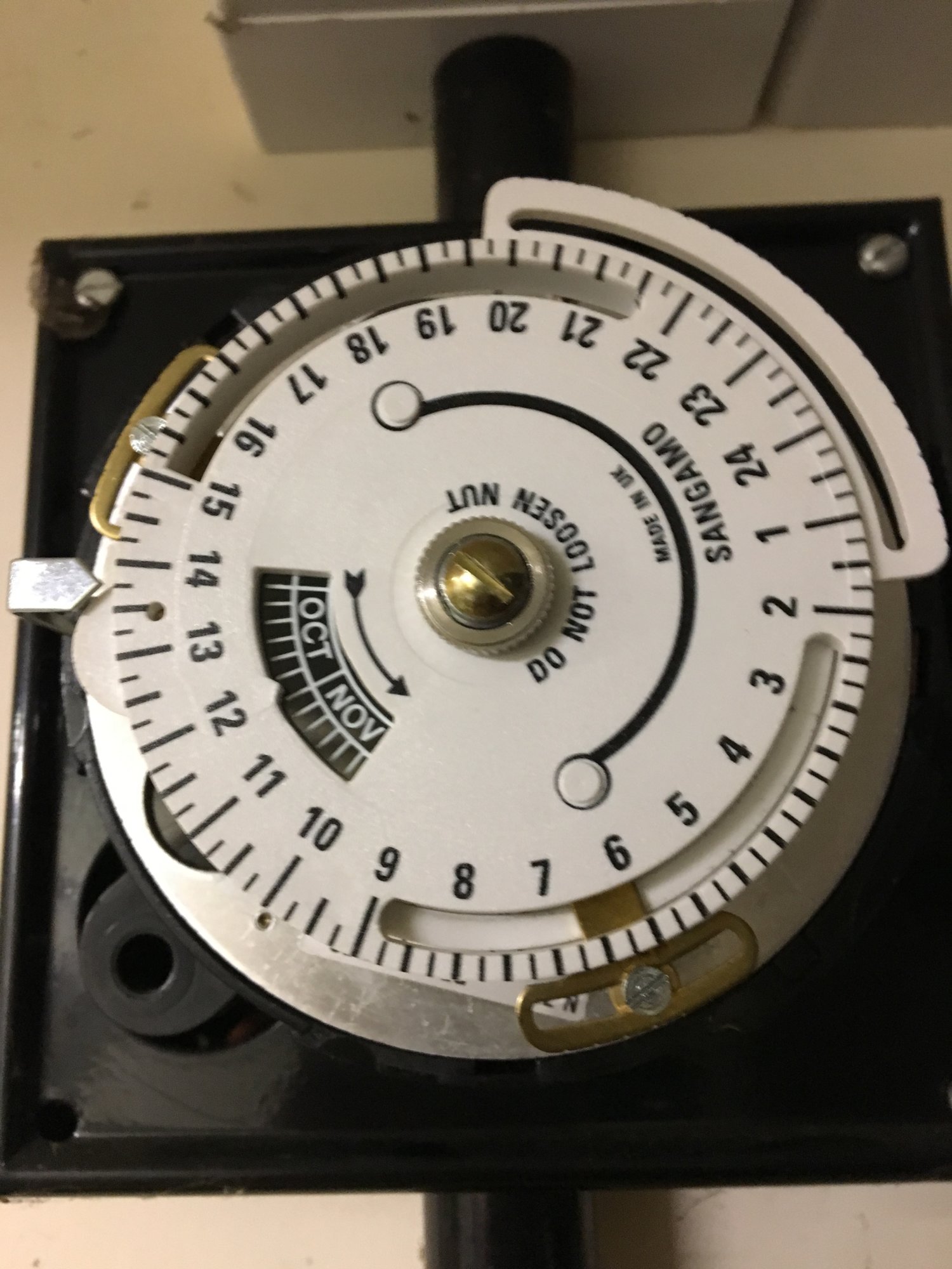

hi all
I have this mechanical switch in my garage that switches on and off some external lights. I can change the time on it but can’t seem to work out how to change the on and off settings. There’s 2 brass parts which I assumed triggered it but these just seem to hang freely. Any ideas on how to set? I googled mechanical switch and timer but couldn’t find anything similar even in gooogle images. Think I need to switch it out for something newer
It says do not loosen the middle screw.
Isn't it a dusk 'til dawn timer which compensates for the changing times throughout the year?
I don't know if you can make minor adjustments.
It looks to be a couple of weeks slow - unless you took the picture a couple of weeks ago.
I can't find it on the net.
Aah thanks that explains it. I’ll have to find something to replace it with. Just had my first electric bill in new house and it was a lot higher than expected so was looking to switch the lights off around midnight rather than dusk. It’s about 8 led lights but every penny counts.

You can move the off screw to the white section at midnight if you want it off at midnight each night, the on time will still track the seasons.
The existing timer can do that.
The driver looks like a 16 or perhaps 25W model, which if on for 12 hours a day would cost you somewhere between £8 and £12 per year in electricity.
Switching off at midnight instead of dawn might save £5 per year. A new timer will cost far more.

In your picture, behind the current time indicator, there is a white 5 spoke wheel if you tick that round it will move the date for you, each segment on the scale is about 5 days

You can use this switch to do this. VERY VERY carefully grip the brass pin with long nosed pliers and remove the screw from the off position at 06:30 and refit them in the white slot at 00:00.
These are very easy to drop and lose so be VERY careful.
