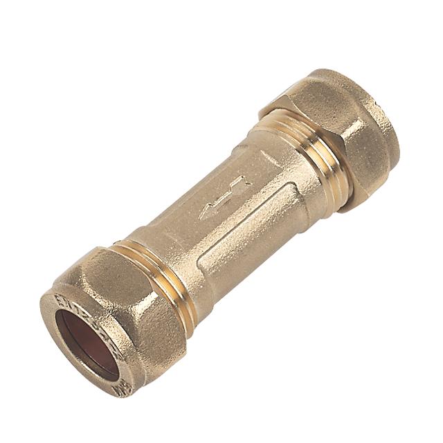

You could also fit a single check NRV to the hot feed of the problem mixer if you can get at it!

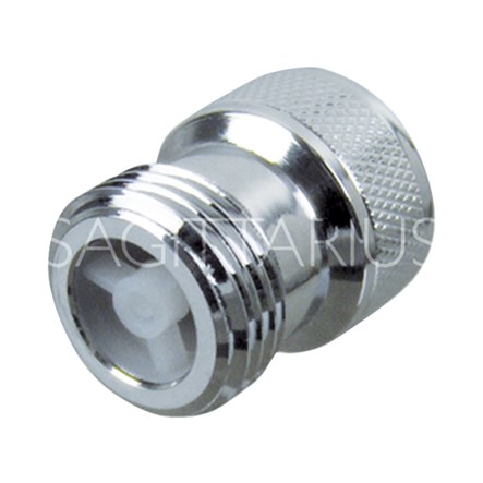

Bought some of these as a precaution but don't think they will fit the shower mixer as it has Victorian type riser with shower can at the top (not flexible hose). Only little single check valves as well, so might get blown apart by mains anyway?
That part is no good. I was referring to an NRV on the HOT copper/plastic supply up to the shower valve, if you can get to it!
