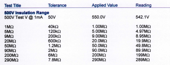

What does this mean?
Surely that function of the meter is to generate 500V in a test of insulation resistance, and indeed the next few rows of the report list what the meter registered for each of the test resistances at that voltage.
So to what was 550V applied? And how, and why? And where did the meter display a reading of 542.1V, and why?
Of course the performance of that function needs to be tested, i.e. they need to check that it does put out 500±50V, and I can see how that might get a reading on the test device of 542.1V. But in that case what is the "550V applied"?
All sorts of relevant questions about that report are being posed but, as is often said in such situations, if someone is interested in discovering the answers, they should ask those who (undertook the testing and) generated the report, not members of this forum (who, at best can only guess and speculate about the answers to the questions).
