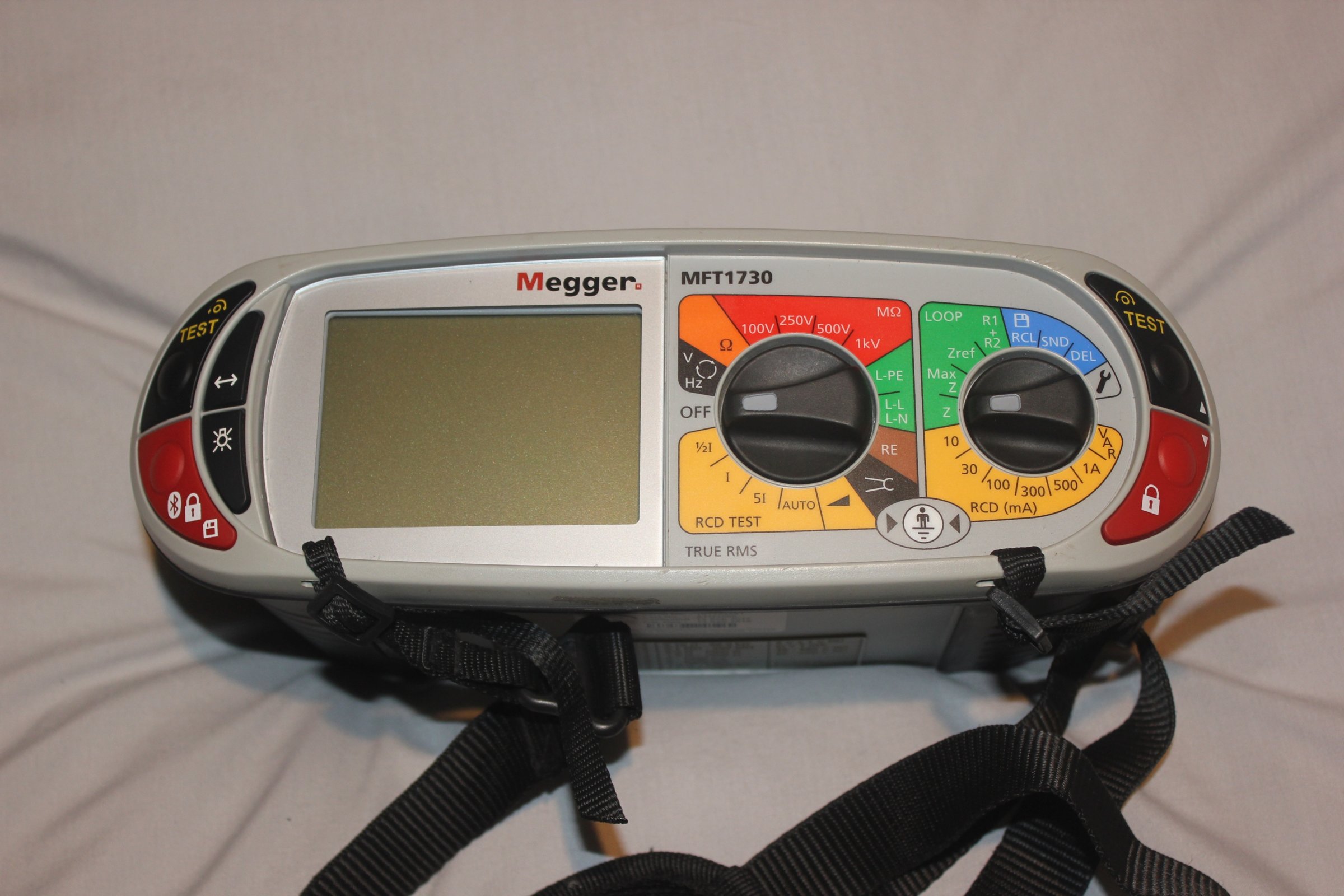

I wasn't looking at Eddie's posts when I mentioned the spec. It has a load of functionality which a diyer will never use (or likely understand). I would say that the make/model of MFT is nowhere near as important as the requirement to know how to use it.
That may well be true, but it has nothing to do with Eddie's participation in the forum, so you maybe muddied the waters a little by mentioning it in reply to my first response to your criticism.
I'm sure no-one would disagree with that statement of the obvious. The same could probably be said of any 'tool' used by anyone (DIYer or otherwise) in any field.
Kind Regards, John

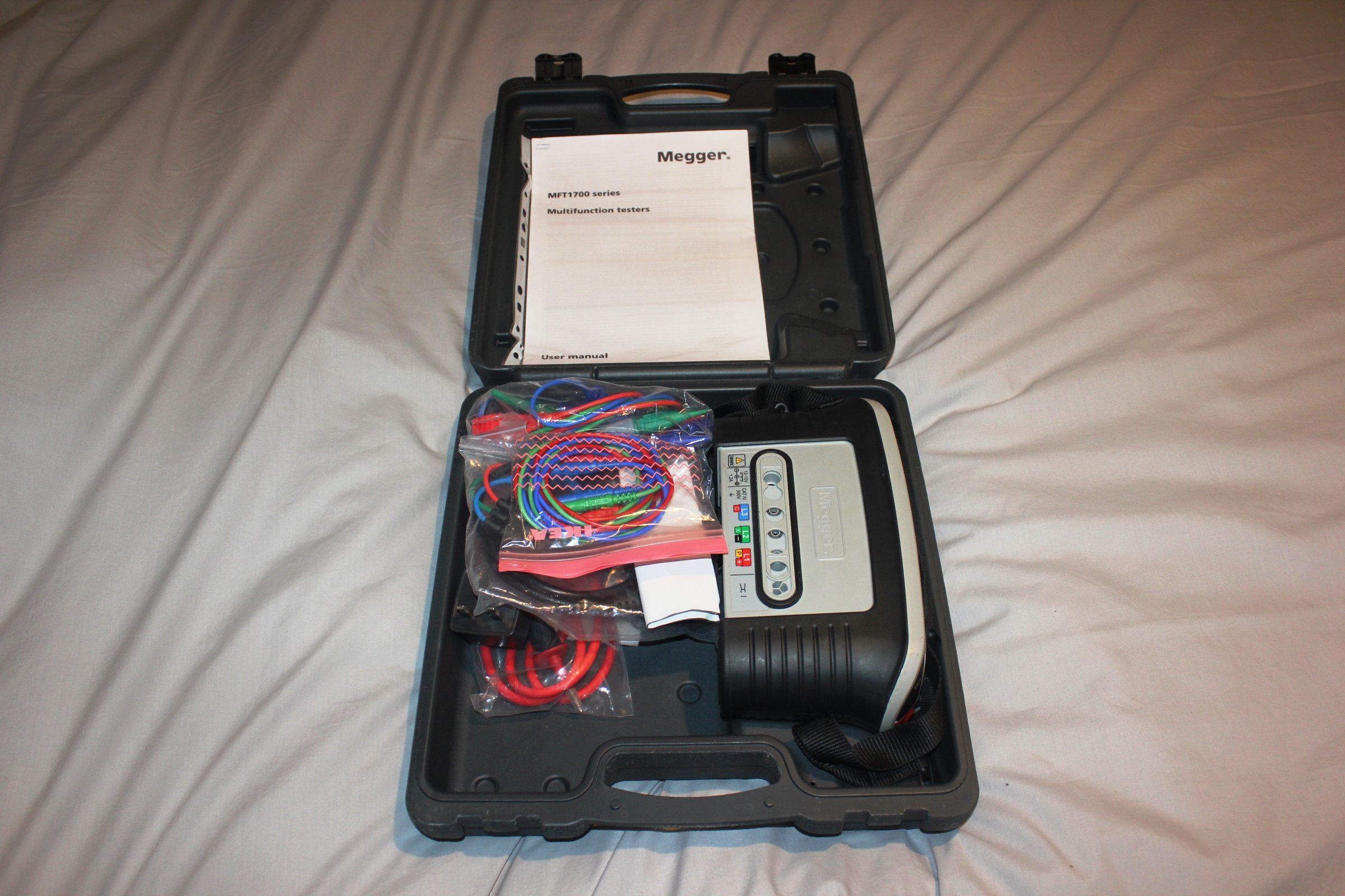

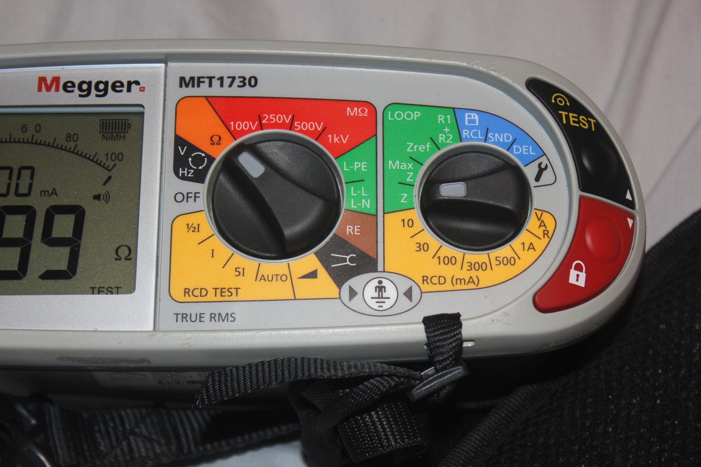

How much experience do you have of testing? It is so much more imortant that you understand what you are doing (and what the results mean) than the make/model of MFT. I'd suggest you read up on I&T (the OSG and GN3) would be a good starter. The NICEIC have a guide and Chris Kitcher has a decent book out, which has links to Youtube videos demonstrating the practicals. If you are on your own and intend to carry out electrical work, I'd suggest you look at the C&G courses available along. The I&T course has a high failure rate because I&T of an installation you don't know is, as you are quickly finding out, a complicated process. I did notice that you laid out the ontents of the box, minus the user manual. It is the most important item in the box and I'd recommend you read it.
Says the one who can not spell "important" :D:p. But on a serious note, while I do understand what the measurements should be for the particular test I am carrying out and how the readings may be affected under certain circumstances, such as unwanted parallel paths during loop impedance tests for example; It is fair to say that I don't know everything, as it took me quite a while to learn and find out that the MK RCD's in my CU were affecting the accuracy of my No-Trip loop impedance measurements.
I went for the model that I did because I wanted the data download and recharging facility's, not to mention the Megger MFT 17XX series are nicely laid out from an operators point of view. The manual in photo two I printed myself as it did not come with a physical copy of one, only a digital version on the CD.
