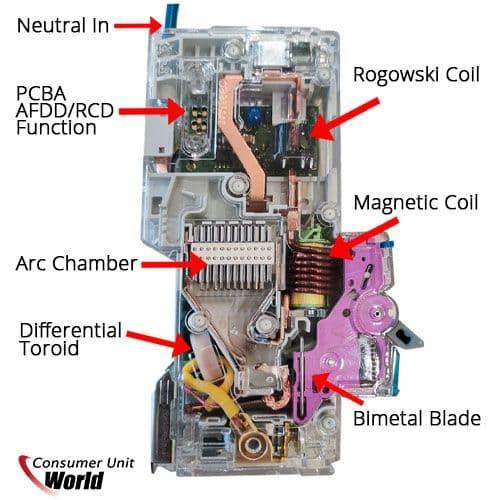

That is what AFDDs are for. Fit one if you are worried.
This is only an option for more recent fuseboards / consumer units - and not all of these - however I'm not convinced AFDD's would be 100% sure of stopping fires
True but reading around it this morning they are a huge step forwards. Mandatory in some circumstances. I intend on having them fitted.

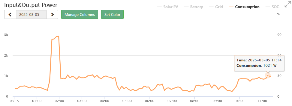

There are so few plug-in items today which use the full 3 kW. 1741174466954.png Use for today, high use charging the batteries with off-peak, but that's not with a plug and socket, the washing machine may be a heavy load, but for rather a short time, same with dishwasher, the tumble drier only uses 600 watt. Well 613 watt at the moment. Showers, Cookers and immersion heater hard-wired the largest continuous load is likely the leaf blower.

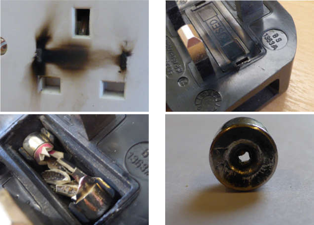

The problem is non-compliant plugs, may be oversize, we see these used,
we know they are not to BS 1363, and when found the socket should be changed, yes, and we are really going to do that, other devices

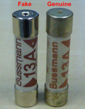

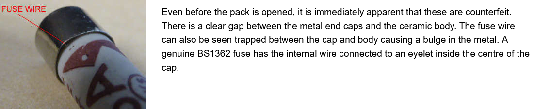

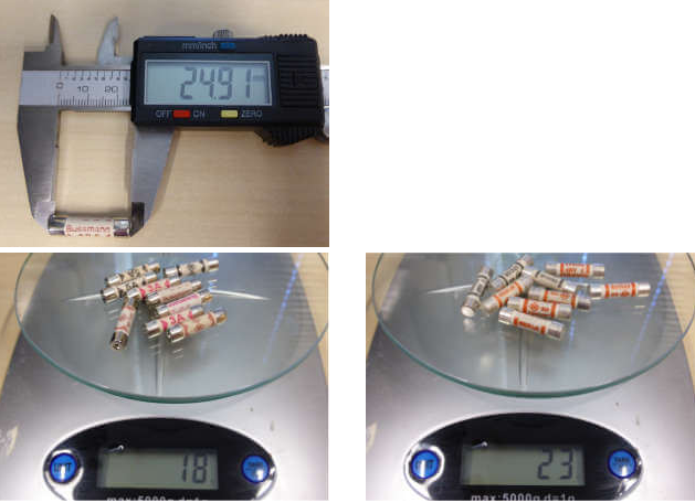

we know when high power is being used, cover should be open, but my outside socket I never worry about. Also, the fuse we see pictures 1741175556198.png on how to tell fake from genuine, and we know the fake produce more heat, We see 1741175719537.png the results blamed on counterfeit fuses, we see the weight and size test, 1741175880632.png now let's see a show of hands, who has ever weighed fuses, or tested length? I never have.
As with all these new technologies, I have to wonder/ask what evidence there is that a significant number of fires result from arcing (rather thn protracted high currents {which would trip an OPD} or residual currents {wihch would tyrip an RCD.RCBO) - and how common such events are.
It is, in my opinion, an important question in order for one to make cost-benefit judgements/decisions, particularly at present with AFDDs being so expensive.
Furthermore, if their use can be justified (in terms of cost/benefit) why do recommendations only relate to sockets circuits, and not to things like cooker and shower circuits etc.?
