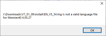

Yeah, unfortunately it looks like they have covered themselves as when you select any language file, even with the relating BIN file, it knows the unit connected does not match and this error pops up:

Can you rename the .lng file to "Menvier_English_V2_25.lng"
Looking at the update manual, that should be a legitimate filename of a language file. There might still be other checks that fail though :(

I tried the file you sent, many thanks for this! But alas, it likes the file, doesn't give me an error, but just sits there with the bar going up for a long time, emptying and starting again!
