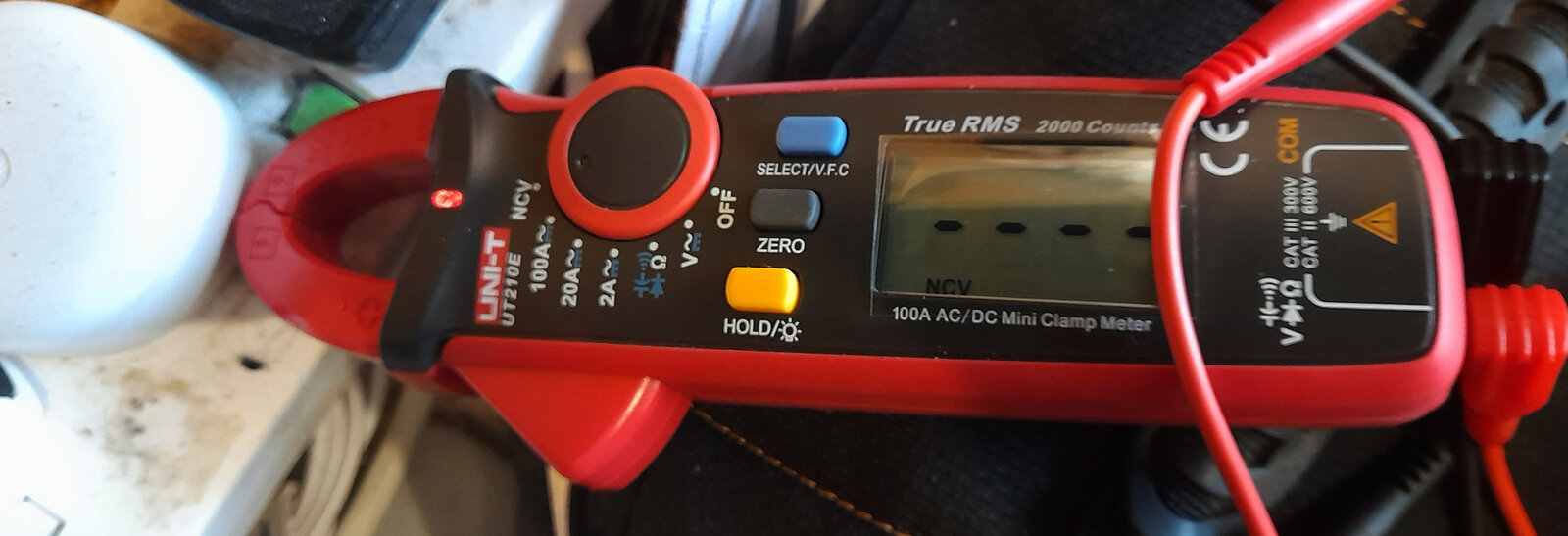

As long as earthed OK, my non contact tester with detect voltage at quite a distance Testing for live.jpg although mine does show 4 levels with 4 bars.
