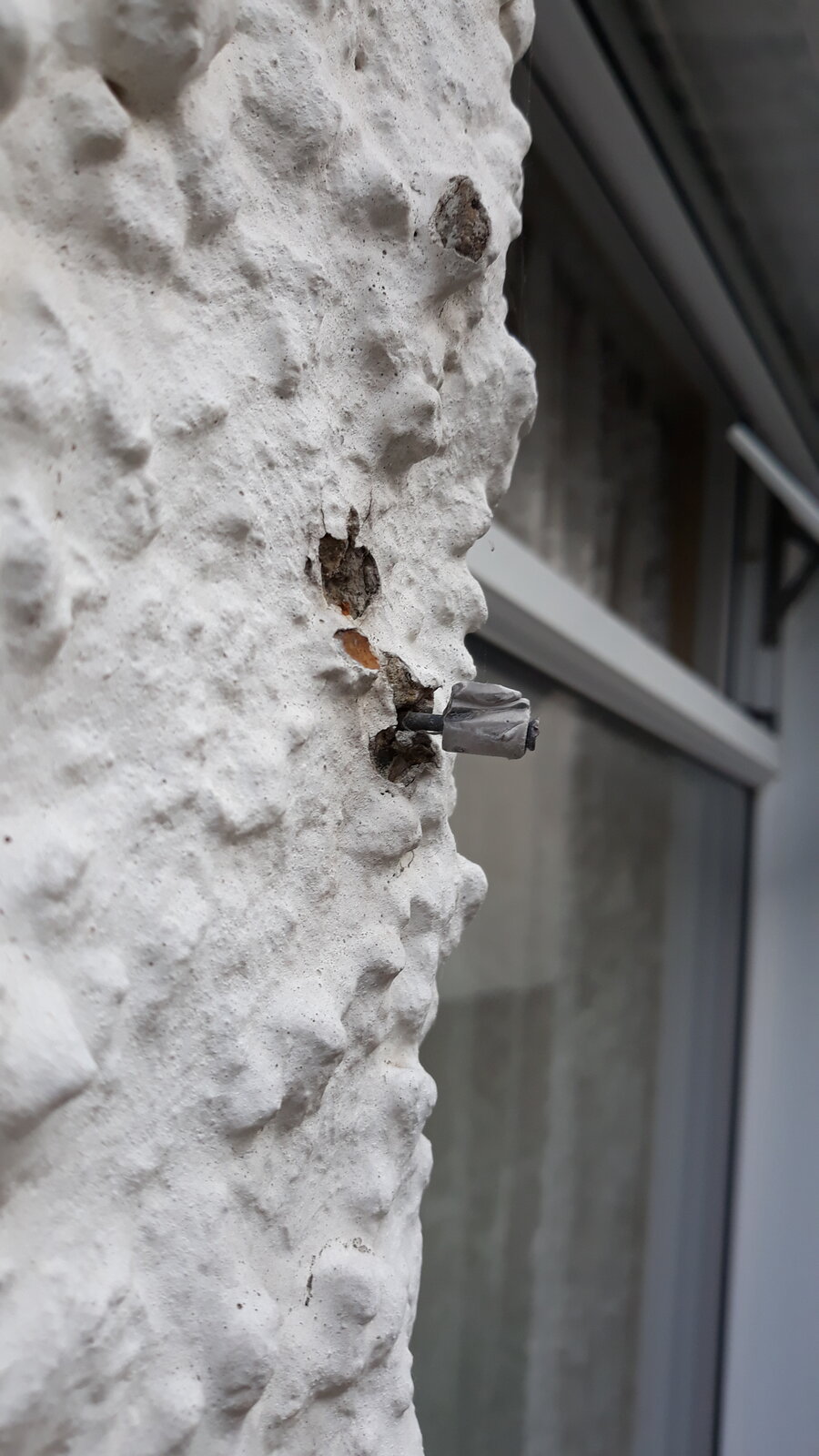

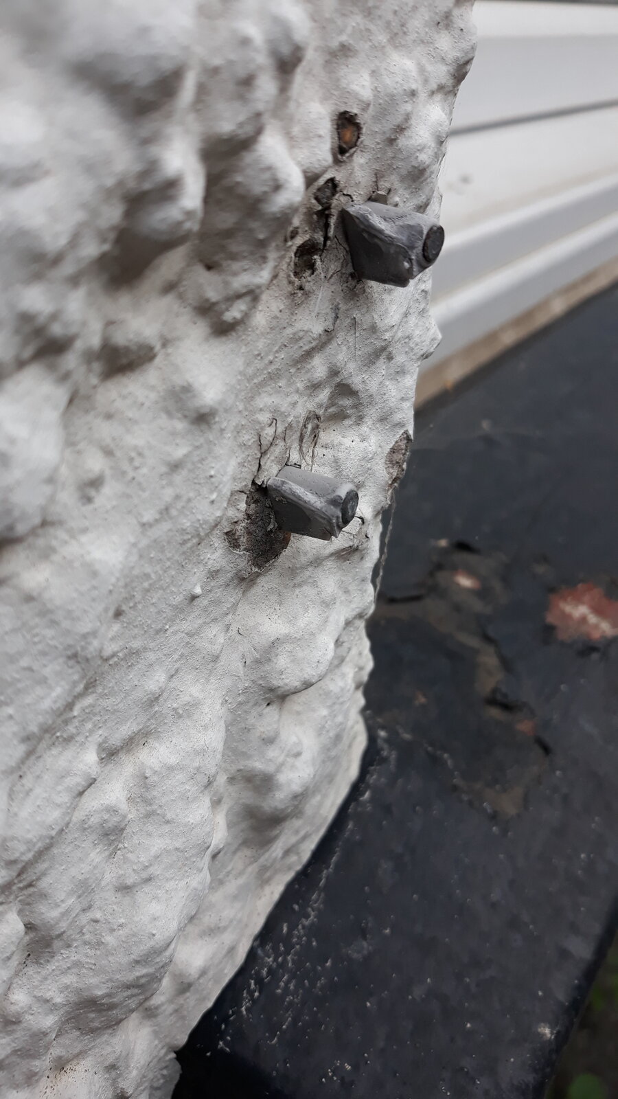

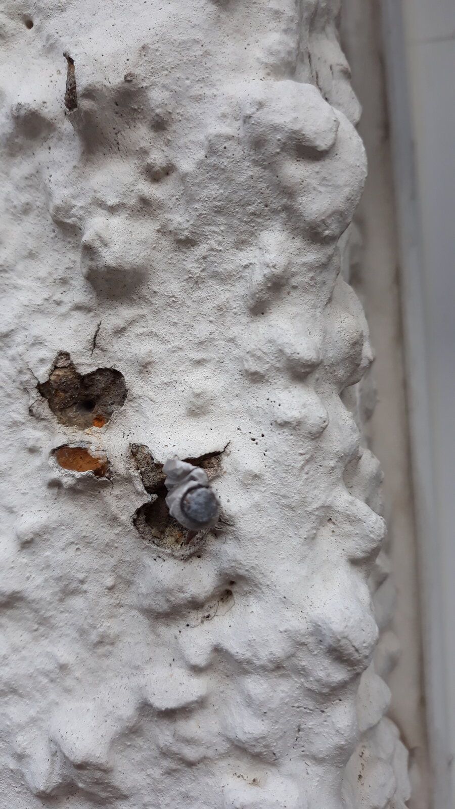

HelloI have spotted some silver colour metal pins going through the Pebble Dash in this property I have bought, have they been used as part of the repair?
No I dont think so they are very tough and well embedded in the wall but thank you for taking the time to reply
Here they are
Old lead style cable clips , possibly for telephone cable, a bit of a sod to pull out once removed fill hole with filler. you could try hitting them sideways with a hammer that will either loosen them or they will snap off .
pull them out if you want to damage the render.
otherwise paint them white and they will blend in.
