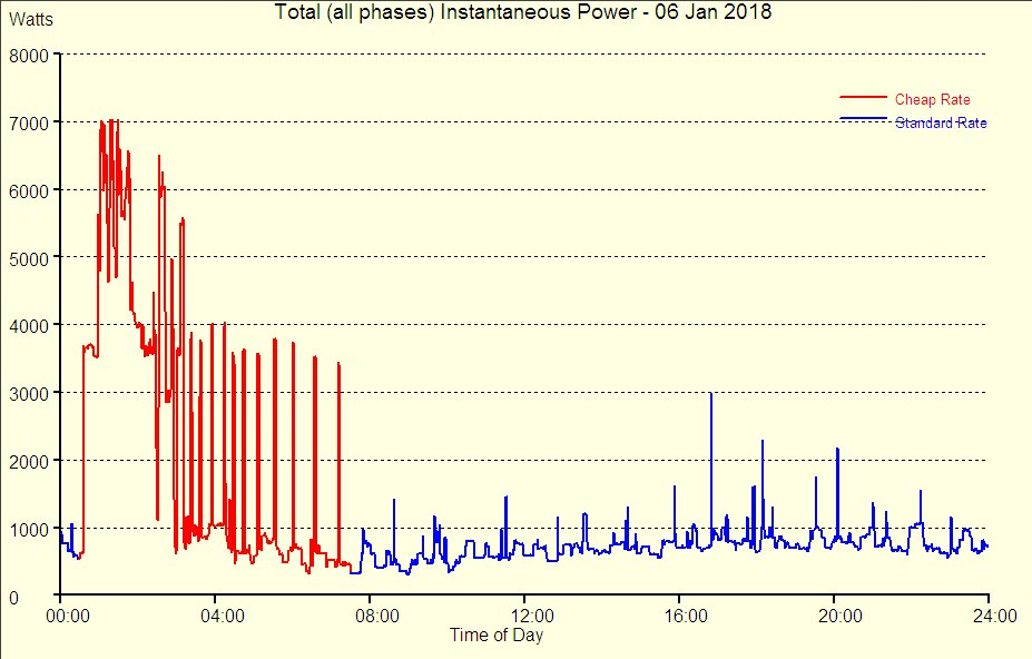

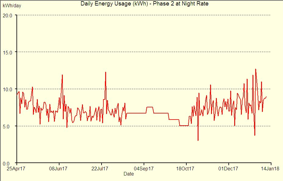

Don't forget that it is a very large house. With the E7, carefully managed, as this graph shows (same glitch in the middle as before), we run at an average a bit under £3 per day, which I don't think is bad going. You will see on the graph the result of 'having a house full' over Christmas, particularly on Christmas Day (daytime water heating {unusual}, secondary cylinder water heating {unusual}, electric showers {unusual}, fan heaters, hair driers and multiple cycles of DW, for a start!)!
Mind you, even if it were a much smaller house, if the electricity was used in a qualitatively similar way, I'm not sure that the picture would be dramatically different. We average 25-30 kWh/day total (day+night), and nearly a third (generally 7-9 kWh/day) of that is the nocturnal water heating, which would probably be much the same no matter what the size of our house. Nearly all of our night-time usage on 'Phase 2' is the water heating, so the below more-or-less represents just that....
As my previous post showed, we do, manage to get more than half usage at cheap rate. The below, from a couple of days ago, is fairly typical of a 'high usage' day. The 3kW jump just after the start of cheap rate, which lasted about 2 hours is the water heating, with 2-3 very brief 3kW top-ups per hour of that for the rest of the cheap period. The 'extra' ~3kW on top of the main water heating period is, I imagine, a mixture of dryer and WM and/or DW. The very brief ~1kW jumps during the day are probably the macerator in our downstairs loo (about 20 secs a go) and the very brief 1-2kW ones probably toaster/hair dryer/whatever ....
