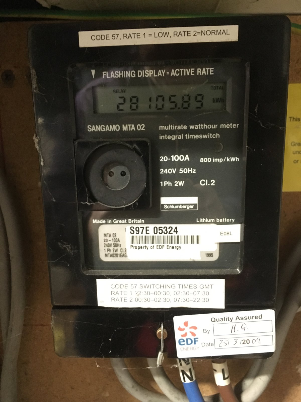

I am on an Economy 7 tariff and have an economy 7 meter that is currently displaying the wrong time by about 35 minutes. It's not a huge deal as we don't have electric heating, nevertheless I would like it to be correct. If I contact the DNO, or whoever, to get it swapped, will they insist on me having a smart meter? I am against having one for the obvious reasons. It was last changed in March 2009, so shouldn't be at the end of its life just yet, but if they have to swap it as it has become faulty, is that a reason for them to install a smart meter? Alternatively, as there is not much benefit for us in having Economy 7, if I was to change to a standard tariff, then would that involve a meter swap? Could I do that and get a new non-smart meter? I don't wish this to become a debate about the pros and cons of smart meters.

Are you sure that it's clock cannot just be 'reset'?
That would be perfect John, although I don't think it can. Here is a picture of the meter... is it one that can be reset? IMG_5152.JPG
Without any specific knowledge, it would seem obvious that the time can be changed.
How else could it work?
Dunno, but since it contains a clock, if that is not being controlled 'remotely' (e.g. by wireless), there has to be some way of 'setting' it. I see that it contains a Lithium Battery and, assuming that's been there since 2009, it could well need replacing.
As a first step, I would certainly ask your supplier if the clock can be reset (and the battery replaced).
Kind Regards, John

Just phoned my supplier, they think they can send an engineer out to reset it. They are checking and ringing me back. Stay tuned!

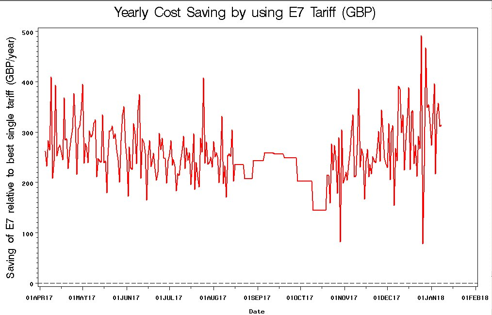

I can't remember the exact figures, but when I did the calculation a few months ago we are about £25 per year better off with E7. Wouldn't be worth changing to E7, but not worth changing to a standard tariff either.
I'm doing quite a bit better than that :) (the funny bit in the middle was when my continuous monitoring system was down and I had to rely on {roughly weekly} meter readings):
That sounds promising. I presume they wouldn't but, if they do it, make sure that they also consider replacing the battery!)

Its all built into the meter. Funny rate periods, but thats what you get. For half and hour personally I would leave it.
At present, I agree. However, particularly if the issue is battery-related, the clock might go far more wrong (or even stop completely) before too long, so it would probably make sense to have it addressed before that happens.
Although the battery is presumably only a 'back-up', in case of power loss, if it gets too ill, it could interfere with the clock's functioing, even when it is (as usual) presumably 'mains powered'.
Kind Regards, John

An engineer is now booked to come and have a look in a couple of weeks. If the clock stops in the middle of the night and we are on permanent low-rate, I might cancel him :D
Incidentally, our supplier said they haven't started providing smart meters yet!
Don't count your chickens - the cunning folk may have designed/programmed the meters so that they default to peak rate 24/7 if the clock stops :)
That solves your 'problem', then!
