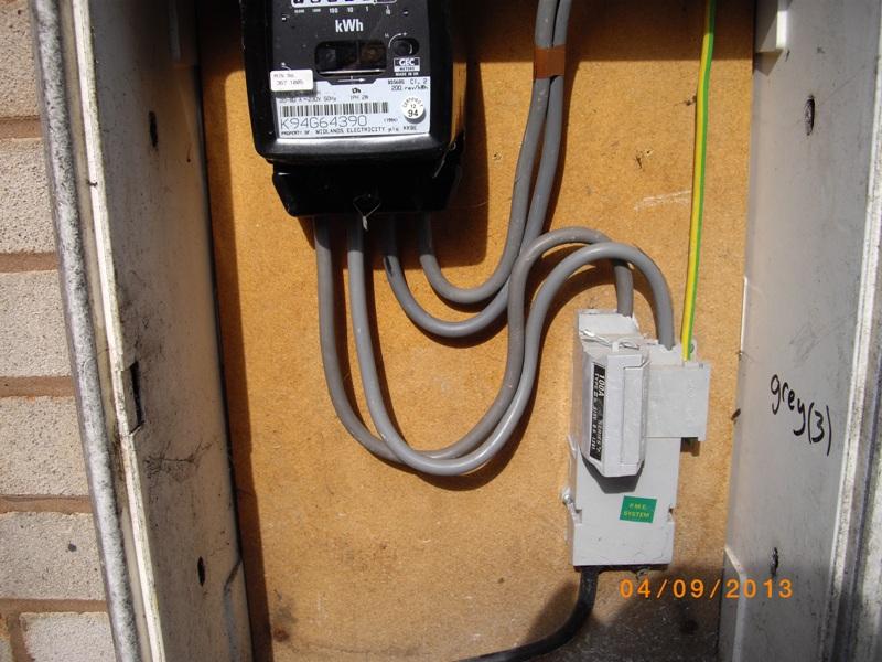

We are looking at getting some building work done which means ideally a rewire & consumer unit move. I've read around on the Internet & seem to get conflicting info. Our supply comes in at the side of the house into what is currently a garage. This will convert to a study so i don't really want the consumer unit in there (as it is now). If we can extend the meter tails by about 4m (i've found 5m cables available) the new consumer unit could go in the new utility area or hall. I've then read that meter tails can't be burried in the wall?? (despite just moving from a new build that certainly did have them burried!!). I've also read that they can only be 3m yet read elsewhere they can be longer but there needs to be a switched fuse by the meter?? Attached is a pic of the current meter. I guess it's down to the DNO to fit a switched fuse? If that is the case can we also request a new digital meter? Thanks for any advice. Hopefully the costs aren't as bad as moving the gas meter 1m (over £1k!!). Our old(new!) house deffo had a switch by the meter.

Seems to vary from DNO to DNO (westie may be along later to verify) but I seem to get the impression that some allow 3m, others 2m.
Beyond that, you do need a submain. The DNO will not fit that. You (or your sparky) are responsible for that.
Meter operator is different to DNO. Why do you want new meter?
Other issue is that nothing should be mounted in the external cabinet other than what is already there.
Meaning, you'd have to put your submain gear inside.
It may be neater to reroute the incoming supply. It could be dear, but it's worth asking the DNO.

The only tricky bit would be that your "not allowed" to put your own equipment in that box, but need a switchfuse for tails over 3m... I suspect you might well get away with putting a switchfuse in there though.

Tails - single insulated and sheathed cable.
They are allowed to be but new tails that are buried would have to be protected by an RCD - not desirable or, in actual fact, allowed for the installation.
My mates flat has the cutout and meter in a box down at the entrance, then SWA running from there vanishing off into the wall/floor, then appearing again at the consumer unit.
SWA being the important part - it does not have to be protected by an RCD.
Tails - single insulated and sheathed cable. ... They are allowed to be but new tails that are buried would have to be protected by an RCD - not desirable or, in actual fact, allowed for the installation.
Why do you say 'not allowed' - because of 314.1? If so, how do you feel about a fuse protecting long tails (or an up-front RCD in a TT installation)?
