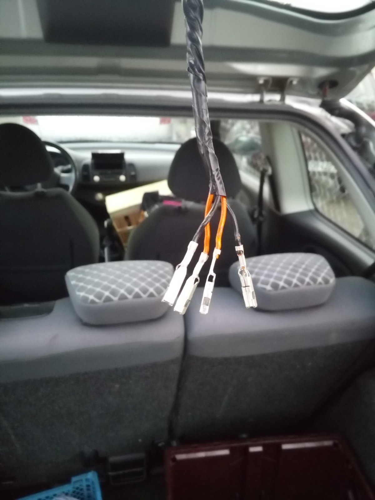

I got issues too with the boot circuitry.
Wires were broken in the wiring harness on right hinge (i'v repaired them) + damaged wire on the boot lock's plug.
Then i make a mistake :
I put off the "wire plugs" of "master plug" and forgot to take a picture of the wiring digram...
Guys, could you help me by taking such picture or telling me the wiring order ? Seems like there is 4 different wire : black, stripped black, orange, stripped orange. Stripped is not clear, so it's possible that there is only stripped black and stripped orange.
Sorry if my english is not correct; it(s not my native laguage :)
