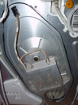

My Miele T294C condenser is blowing only cold air, and I'm wondering whether it perhaps happened after a power-cut we had.

You need a T20 torx bit....try Halfords.
There is no "reset" button...either on the machine or the thermostat behind the cover you need to remove to check it.
You will need a multimeter/continuity tester to check the thermostat & heater element...try halfords....;)
Remember to pull the plug before doing anything :eek:

The cover tends to stick on the silicone seal. You need to lever it off...it will release.
I now got the back plate off, thanks. The silicone seal didn't stay intact, but more on that further down in this mail.
Behind the back plate was a heating element, with 2 leads attached.
I was just going to locate the thermostat, and bash it like described in the other thread, since I don't have any meters to measure with.
However, looking at the heating element, I am not sure which one is the thermostat, is it the one on the left or the right?
And what is that black, round thing above it?

You need a circuit tester or cheap meter to check the thermostat, again try Halfords they only cost a few quid. The thermostat is the largest one (on the right of your picture). The one on the left is an NTC sensor. The "black thing" in the middle is the bearing cover & has nothing to do with the heater.

Susanne; although a tripped safety thermostat is a very common cause of no-heat issues & one of the first things to check.....it is only one of several possible culprits. You really need to confirm it has actually popped. If you get hold of a meter you will also be able to check the heating element and NTC as well. It is possible to reset a tripped thermostat by "shocking" it as explained in the other post, but you don't know for certain it has popped in the the first place. Whatever you do don't bang it on the connection end, it will break it & a new one costs around £25. If you want to go ahead & try to test it anyway refit the cover first. Then try it on a timed cycle (you will feel heat on the outside cover if it works). If it heats on a timed cycle try it on a program.
