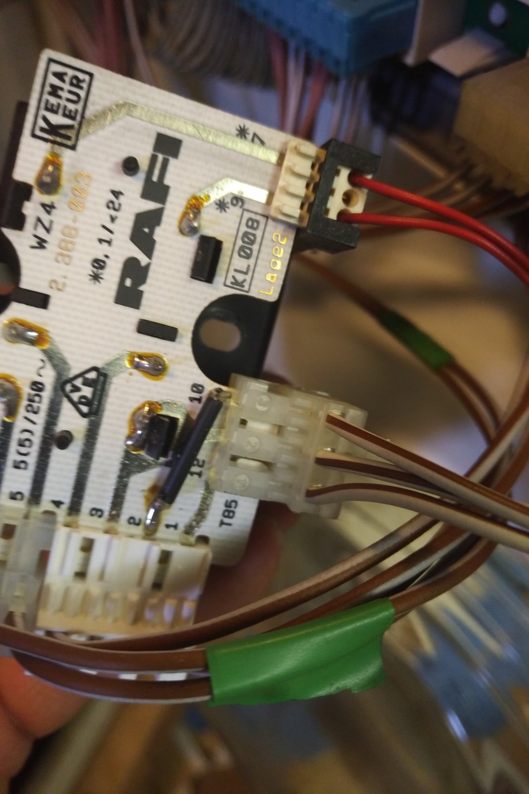

When the latch is closed power can flow between 11-12 on the door release/power board

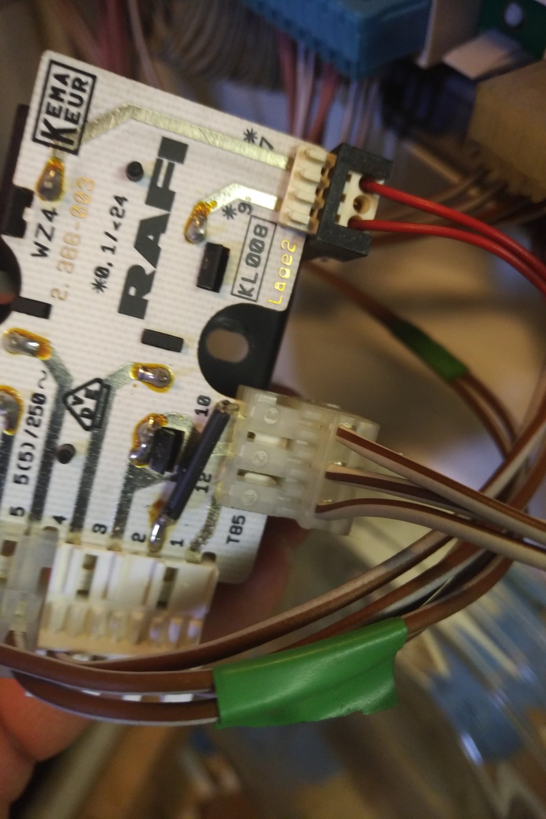

You were right light wires with a brown line on each. I was able to test the continuity between the pins, which was fine and the active line between the door lock piece and where it attached to the "RAFI" board with the start button and door orange door release button. Also ok. Then I tested the little black piece off the live line on each end (I think 10 and 12. There might have been an 11 underneath too). Again ok.
I could not seem to get the buttons for the start and open door off the electronic "RAFI" board to to test to see if as you thought, it might be a broken solder joint, so I have not tested that as yet.
I pushed and tried to make sure all of the wire connectors that I could be wee properly secured. They all seemed to be push on fit but I could not get them loosened off any of the Boards. the only ones I could take off were the ones at the door interlock end.

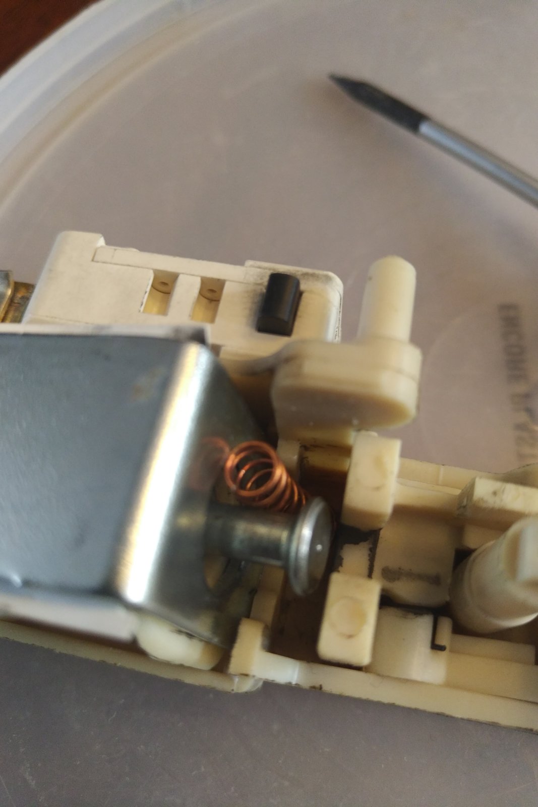

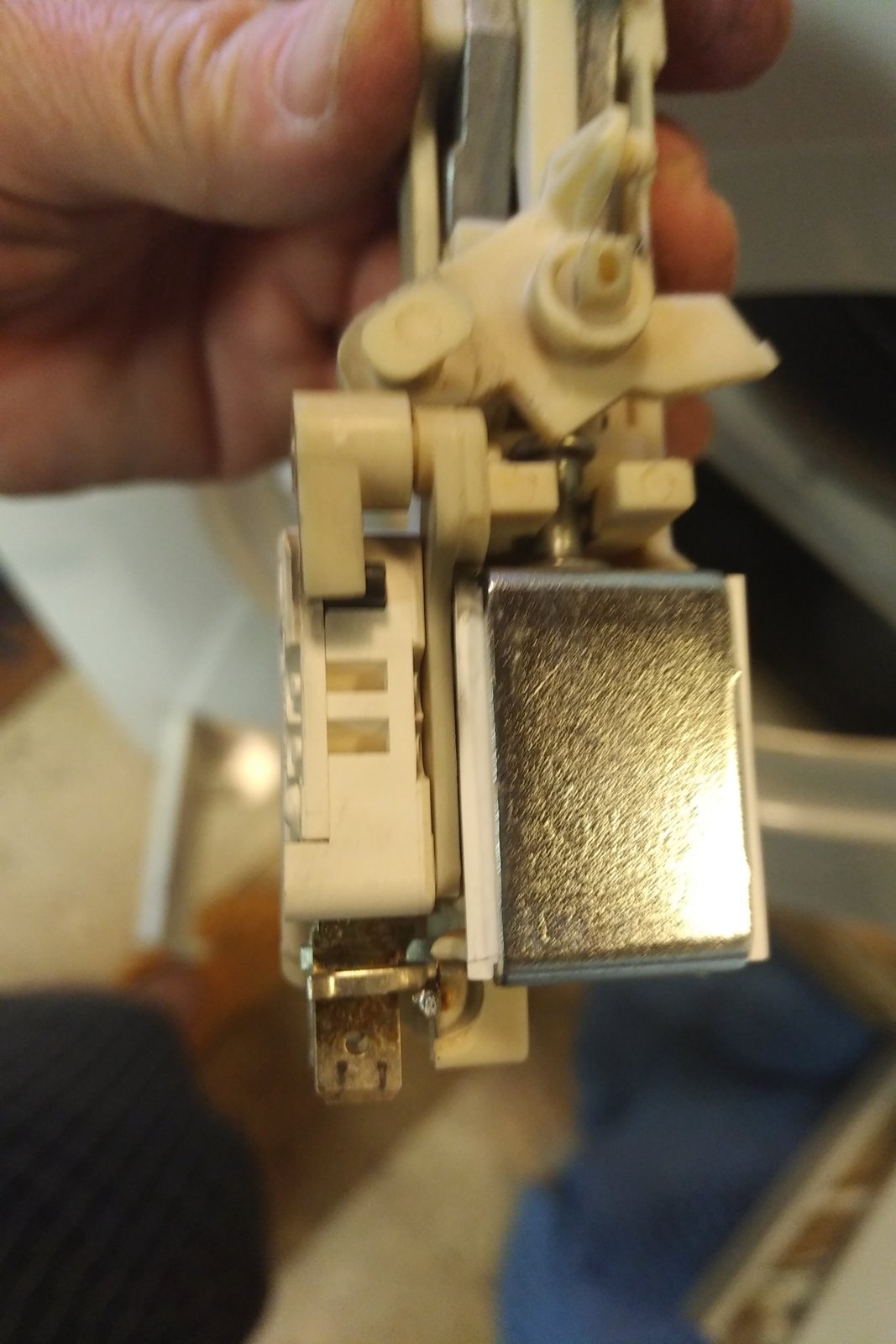

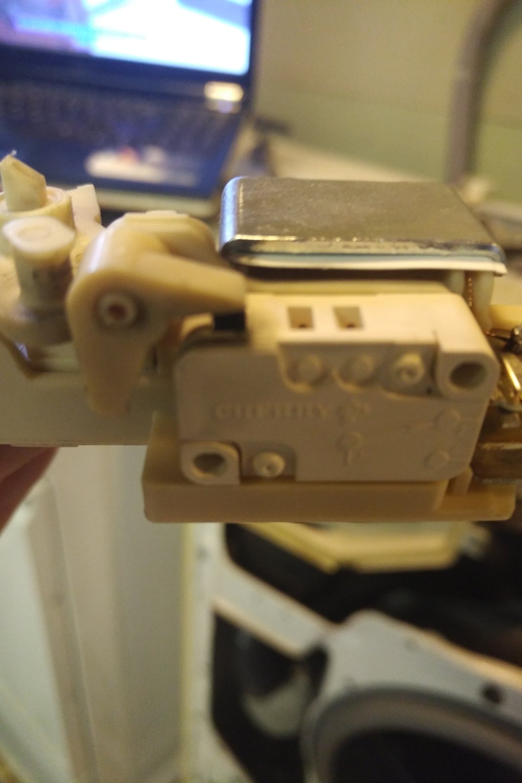

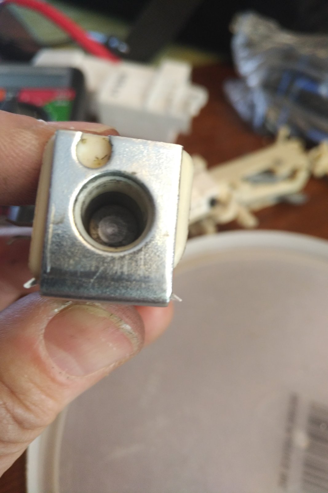

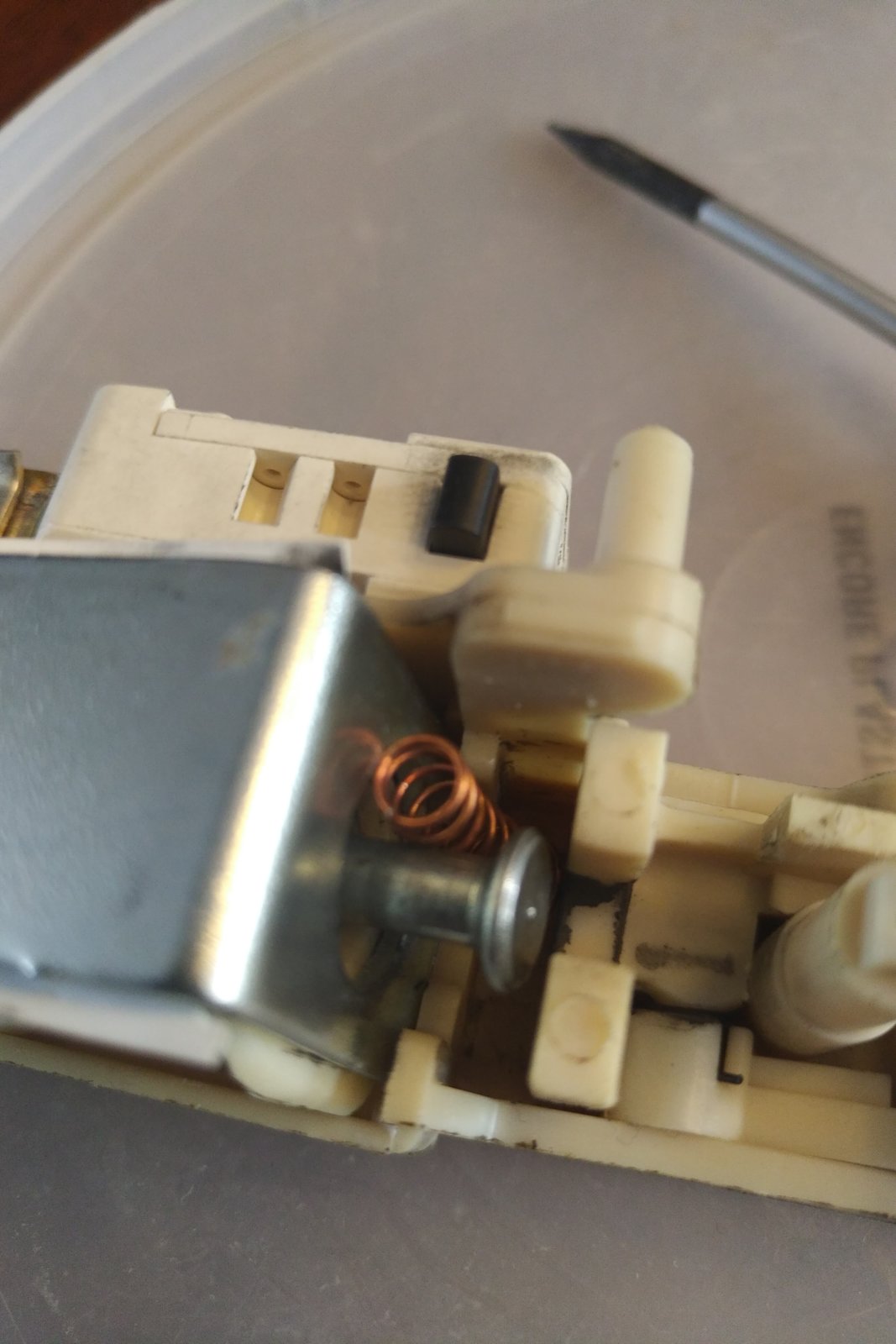

I then took the door interlock off and took it apart. Other than getting my hands dirty, I am not sure I accomplished much except to be interested to see what an apparently simple mechanical thing it is and wonder how it can be worth $150. Three springs loading various levers, 2 plastic moving arms or gears (one for the manual door open pull) and then a little metal barrel/piston looking thing which fits over a plastic spring loaded flat piece which is maybe supposed to move when the door is locked in place.
I watched Russian (I think)video on how to fix one. Problem is their sensor is a copper lever which heats up and then a spring which if tight enough closes the circuit to tell everyone the door is locked down. He fixed it by stretching out the spring. The w842 door interlock looks entirely mechanical with a plastic spring loaded piece attached to a metal piston like piece which fits into a round tube with a metal end and wire going to the live prong (of the 3 prong connection) . I will be annoyed it it turns out to be as simple as the little plastic piece is not moving enough to push the piston in, but it does not seem to be able to move much.
So here is how I think it is supposed to work? Maybe you can help.

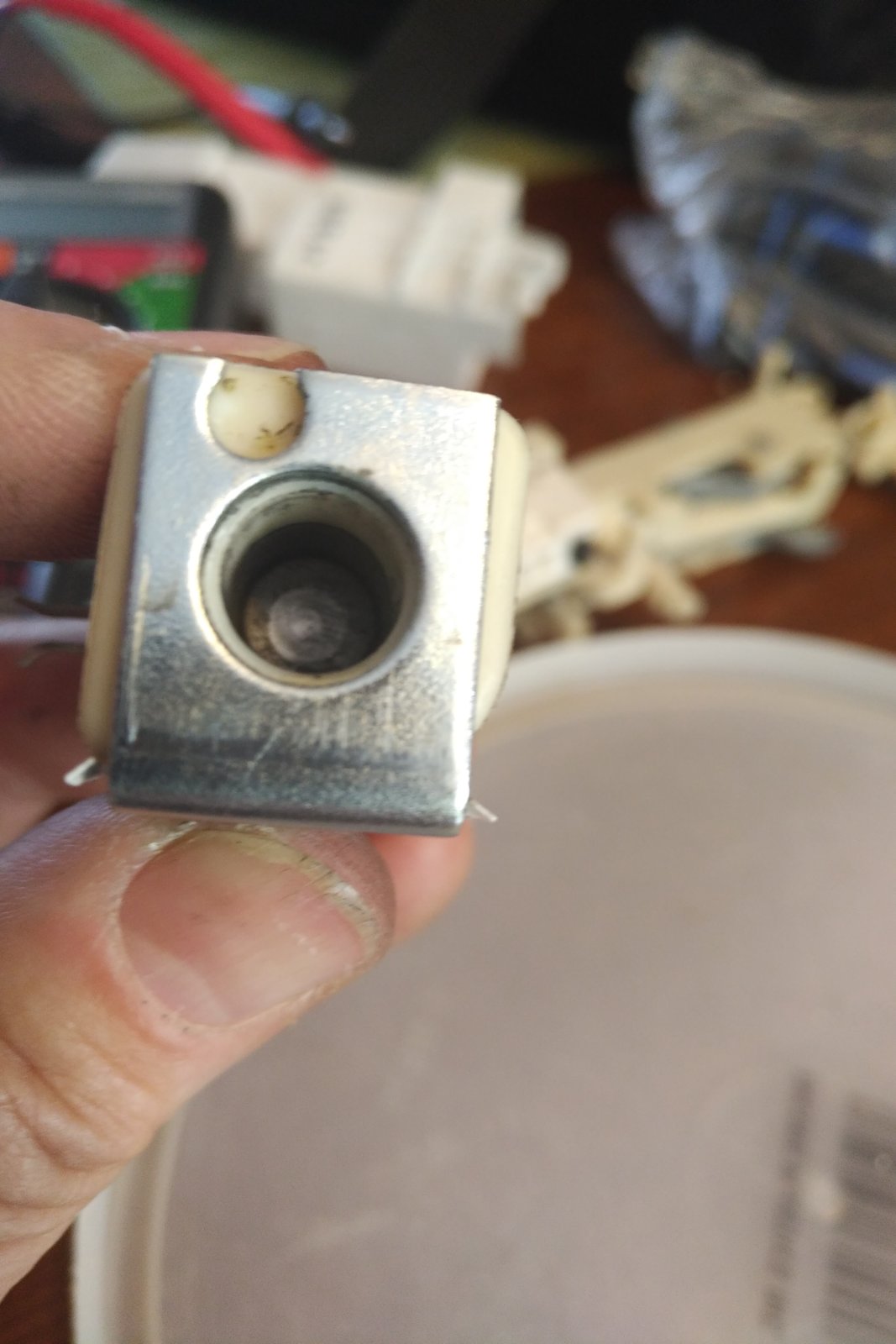

1. The piston slides in and out of a sleeve with a metal pad inside which I think attaches to a wire going to the live prong on the 3 plug prong ( which plugs at the other end to the start button Board).
2. When the door latch is engaged, I think it pushes on the flat spring loaded plastic piece which then (not sure which) pushes the piston in against the metal end of the sleeve (or maybe pulls it out of the sleeve, which does not seem right) thereby making (or breaking) an electrical connection to the live door lock sensor wire on the 3 prong connection.
3. Message goes along wire to RAFI board controlling start and open button
Two things which I could not get to work exactly as I think they are supposed to:
1. the plastic and metal pieces which you say "click" only did so when I had the door interlock apart and manually pushed on the latching mechanism, which seems to be different than when I push the door closed. The door seems to have some spring/movement to it when closed. Not sure if that makes a difference. I checked the rubber door gasket to make sure nothing was holding the door from closing all the way.
2. Also I could not get a connectivity beep between the inside metal end of the sleeve where I think the metal barre/piston like thing is supposed to touch to close the circuit (and tell everyone the door is closed) and the wires coming out of the sleeve to the live prong or anywhere in the wire to the prong. The wire looks clean and intact so wondering if there is something other than a conductivity test I can try.
I have uploaded a few pictures since a verbal description never seems to be as good.
So it is the door lock for sure. I found several small plastic parts/levers which broke off and eventually fell to the floor. I have tried to jam the lock mechanism to make it think it is locked and now the door will not engage or stay shut. I hate to give up on it because it is such a [ain to get in and out of my basement but it is 20 years old.
