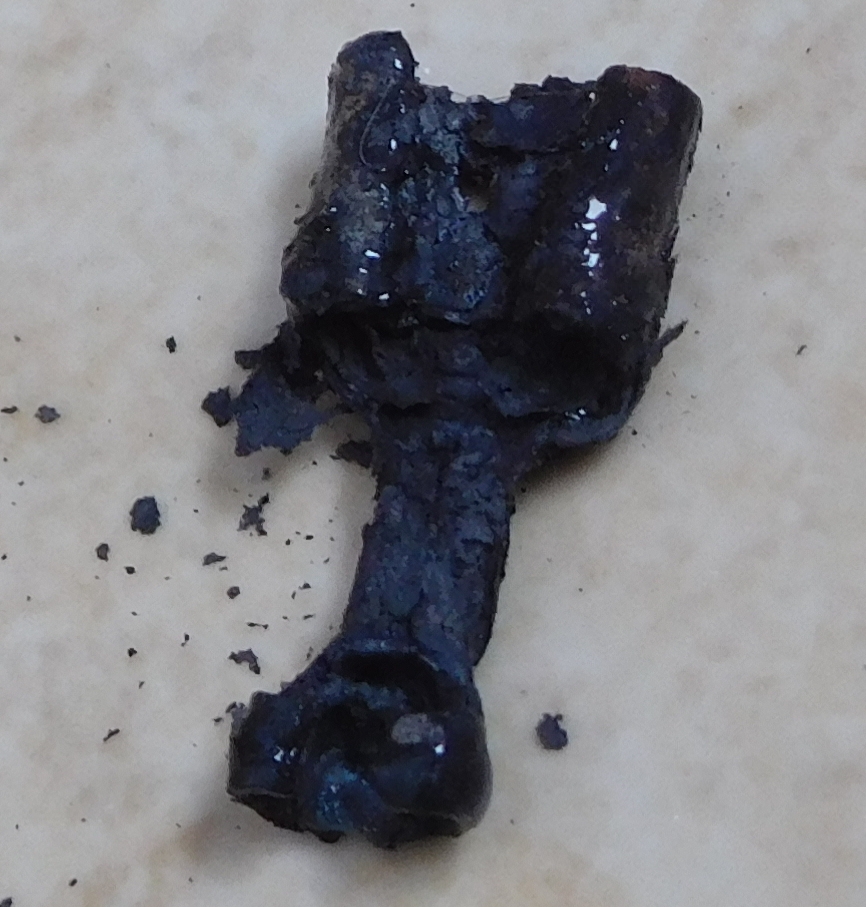

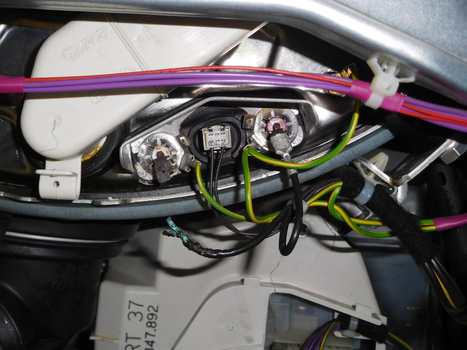

My Miele W3204 washing machine stopped heating the water, so I took it apart and found the spade connector on the bottom of the machine, burnt off, and the cable connecting it to the heater element also burnt off. Does anybody know why this might have happened? The heater element was about a year old, I replaced it myself. I have a new replacement element ready to install, a heater relay and a new temperature sensor (as I didn't know what was the cause of the fault before I dismantled the machine, so I thought I would get all the parts to save having a dismantled washing machine taking up space while I waited several days to get a replacement part.)
I don't want to put in a new heater element without first doing whatever is necessary to prevent this from happening again. Could it have been a faulty element that caused this? I bought it off Ebay, it was around £20 and wasn't a genuine Miele one.
The machine hasn't been heating water for about six months, so I've been using it with hot water from my gas boiler (it's always had the hot water pipe connected to it, as I have the cold water pipe plumbed into the dishwasher next to it- that's just the house was set up when I moved here, so I thought I would leave it the same), so if there was any water that caused a short circuit all those months ago, it's long gone now.

That has happened to me, caught it as I could smell the wire coating melting, In my case it looked as if it was becuase of corrosion and or being loose increasing resistance and making it overheat and burn.
Due to damage, I could not tell if it was on the wire to spade interface or the spade to heater interface.
I cut the wire well back to good clean unheated copper.
Crimped a new spade onto teh copper wire with a professional tool.
And is then soldered it.
I also make sure spade was slightly more squashed so it was tight onto heater terminal.

Yep, as above, the spade connector was loose, or otherwise not making adequate contact with the terminal. The small amount of resistance, caused the contact point to heat up, making the contact progressively worse.
Looks to me that the original spade connector had an insulating sleeve on it. Probably when the new elements connector was pushed on rather than the spade connecting firmly the blade on the element went between the back of spade connector and the inside of the sleeve cause a high resistance connection. Something easily done especially if you don't know how stiff it is to push a spade onto the blade. The high resistance connection when passing current and heating the element the spade connector would also get very hot due to the poor contact melting the insulting sleeve or even causing it to burn.
Hi Diver Fred, if you look at the second photo, the right hand spade connector is the same as the burnt one was - I don't think either had an insulating sleeve on them. I did put the spade connector on correctly the last time, but I can't guarantee it was as tight as it might have been, from memory - but now I'm a lot more careful about these things. I wonder if the electric cable itself was no longer securely held by the burnt spade connector, and that's what caused it to fail.
I gave the washing machine a test at the 95C setting, the door was too hot to touch after about ten minutes, so it's all working fine now.
