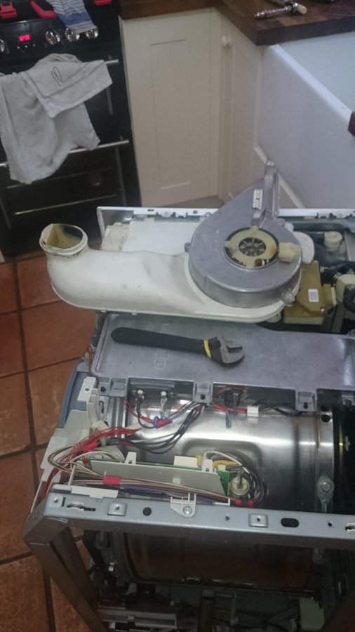

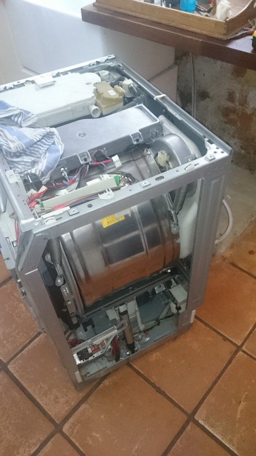

Shout if I can't remove the side and would have to take the drum out for access, I'm going in! Will try and remove the offending item from the depths of the beast...
I have the beast in my sights...

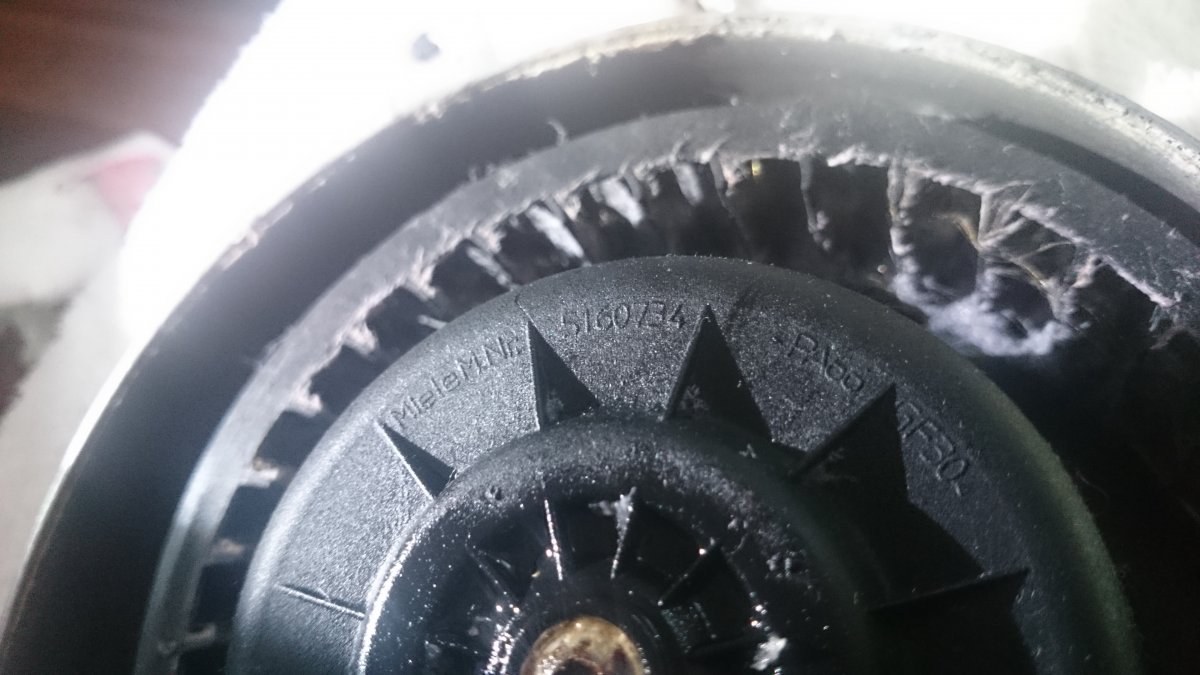

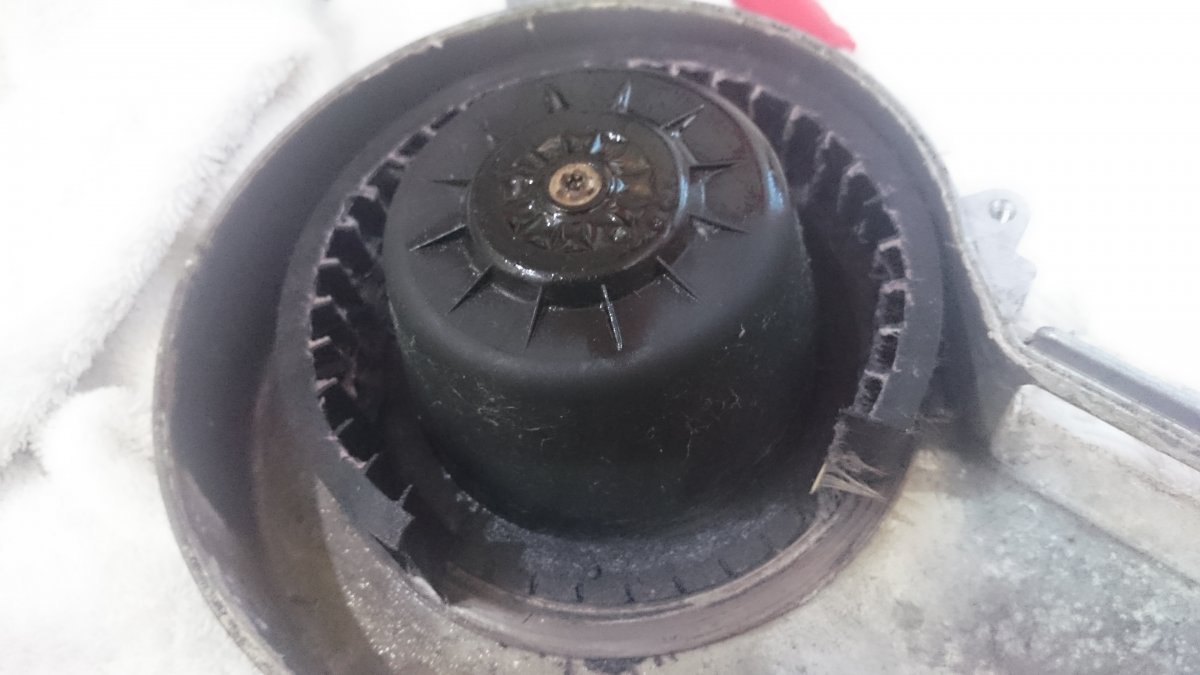

I'm guessing this part of the fan shouldn't be loose.

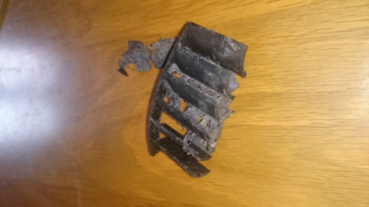

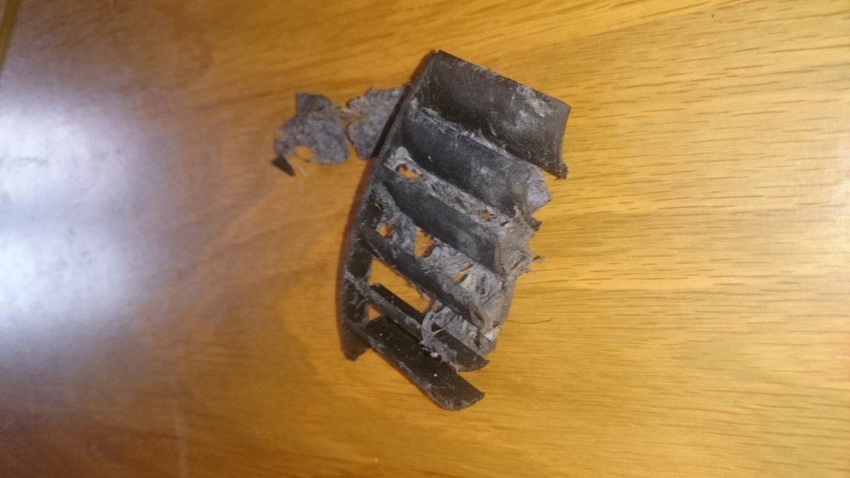

Show me some love guys, can i get a hoowah :cool:
So, is this a serviceable part? Guessing if I put it back in as is (cleaned up) will just fall apart some more (n)

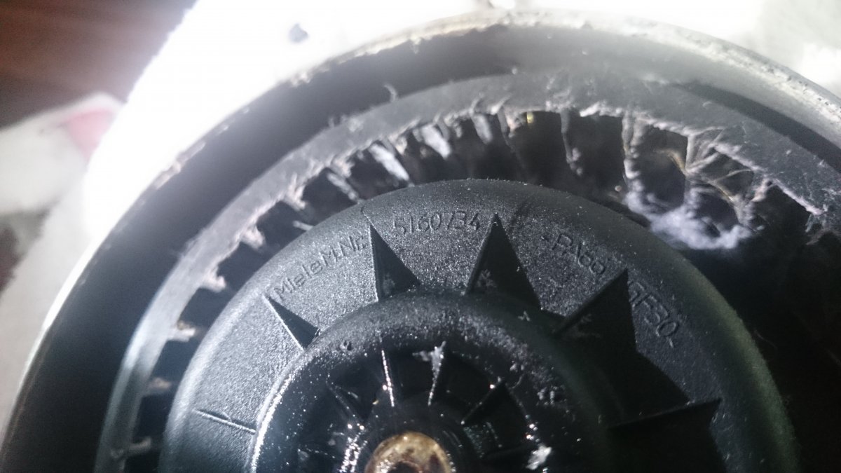

OK from the fan blade shape and from memory when it was spinning guessing as you look at it spins anti clockwise. Screw is a T20. Soaking in wd40. Is it definitely going to be clockwise to loosen? Ie opposite to normal? Really don't want to round this sucker off.
Cheers!

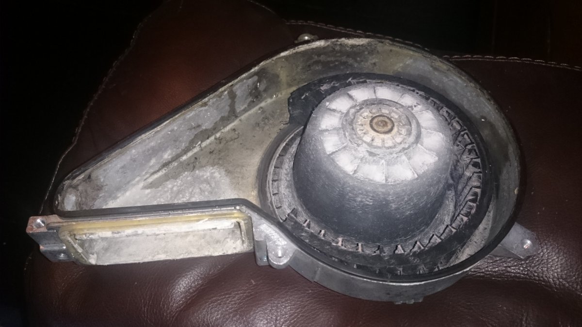

Of course it's rounded off. Assuming I can dremel a slot in the screw and get it out have a ordered a new fan for £40, main gasket £20, lower gasket £10, plus delivery.
