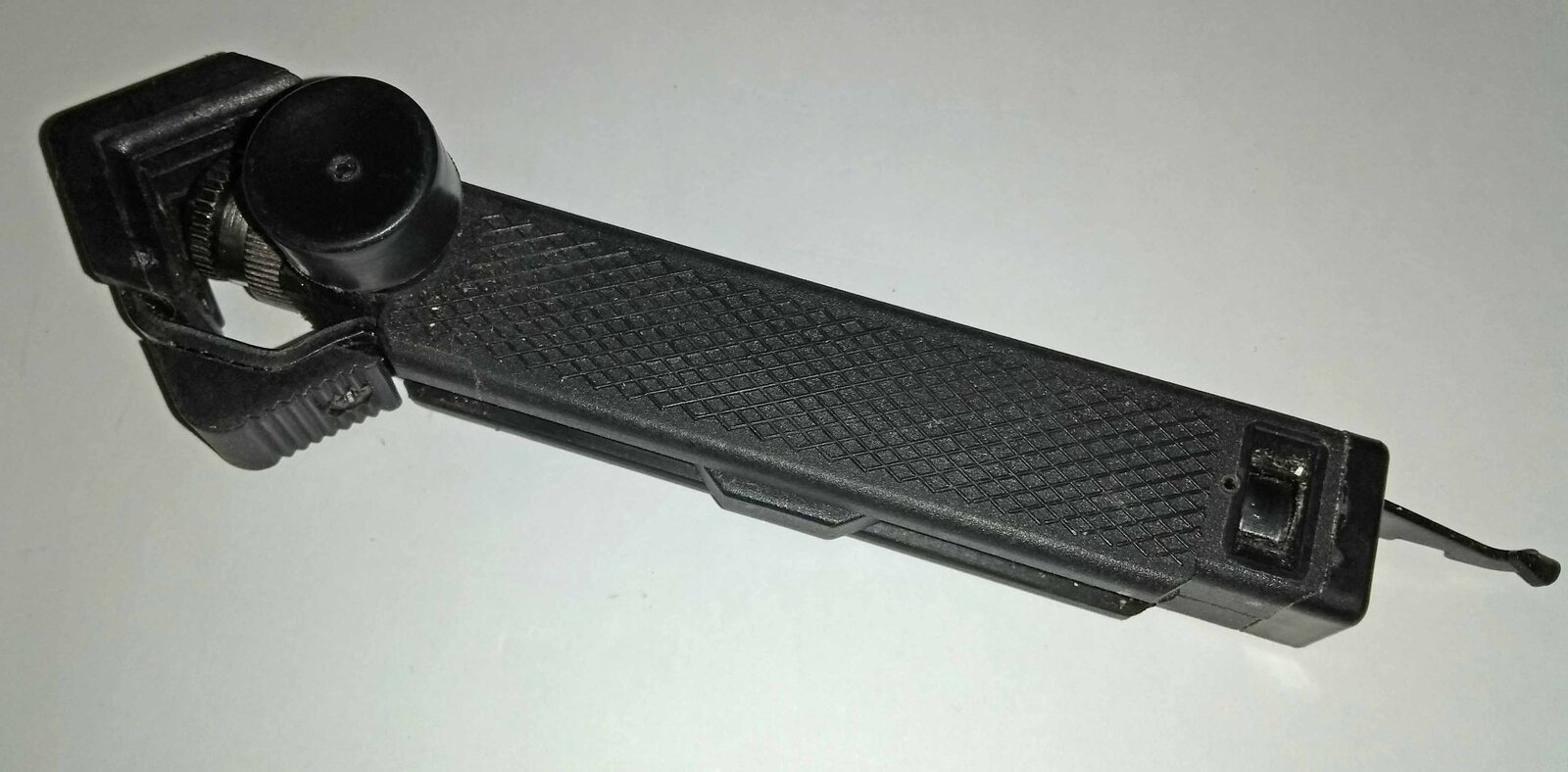

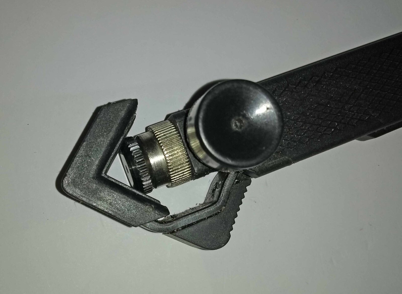

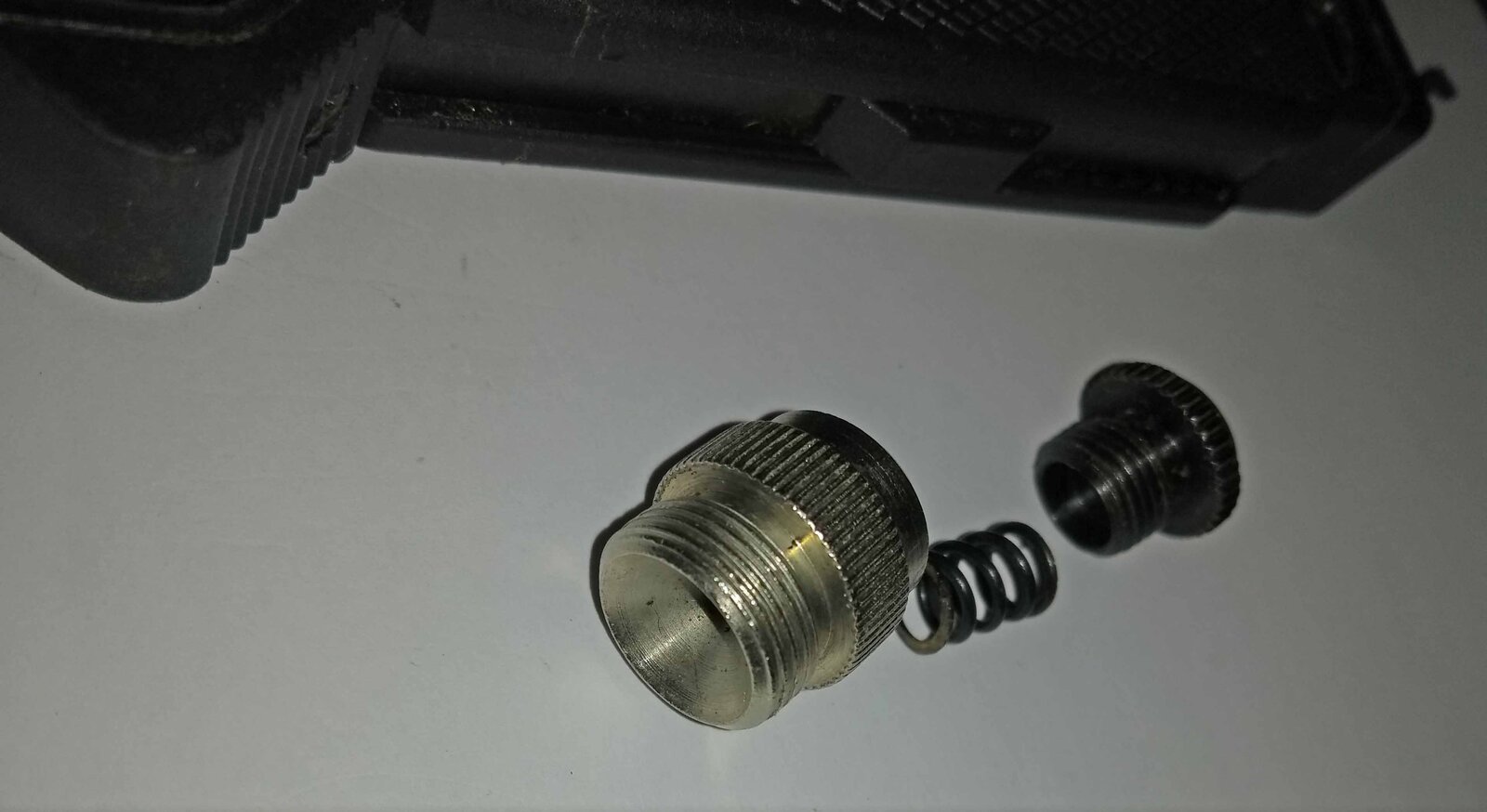

I was clearing out a late colleagues collection of electrical/electronic tools when I came across something odd looking, which through a google image search, the mystery item has turned out to be a Miller MK02 cable sheath cutter.
It looks like it might be quite a handy bit of kit , as pressing the button rotates the blade and allows you to do lengthways cuts as well as around the circumference of the cable. But although the tool is supplied by a small number of UK suppliers, this is missing its blade and those seem to be a bit more difficult to get your hands on and quite expensive.
I was wondering if anyone out there uses one of these and can comment on whether its good enough to be worth the effort of tracking down new blades?
Thanks!

I used to get them from CPC, a pack of 5 was about the same price as a tool. They don't seem to list them now but:
They were a bit of a Marmite thing but if setup correctly they work ok but not something to easily use on multiple cable sizes.
Personally I haven't seen one in use for years.
I use mine quite a lot as I am often dealing with assorted multi-core cables BUT they can be a pain on the thinner jacketed varieties for example 4-core alarm cable where it is quite easy to knife the cores. I usually try a short inch strip first to get the knife setup. I must admit it languishes around the bottom of the toolbox in between times but I wouldn't be without it as the alternative stanley knife is much more fiddly and liable to damage the cores (or my fingers). Sorry no idea where to get blades from.
Thanks all. When I've had a further look around, they seem to crop up on sites relating to fibre optic cable outer sheaths and I can see why it would would work well on plastic that tough. Equally @fourtytwo I can see why it would be unsuitable for alarm or telephony cable as the spring is fairly strong and I can see it distorting the shape (I'd be using the stripping cord you get in those types of cable anyway). I don't think it's worth me bothering with it as I'd probably only use it for mains flex, so rather than chuck it, I might put it up on ebay and see if anyone wants it.
@Murdochcat - if you have any spare blades for the one you lost, and might want to replace yours, by all means PM me.
