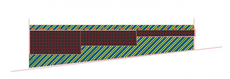

Thanks.. I dont think i was clear enough..
This is a refurb. The existing oversite is sloped. I want to level it into 600 wide terrace like formations. On which different thickneses of polystyrene insulation boards (EPS expanded or XPS extruded) will be applied that will then bring the overall floor to one level. the UFH pipes will be laid on top. (god only knows where UDF came from)..
So the question is... the existing oversite is there. i intend to put a tapered thickness of concrete/screed. that will then bring the floor level. What is the min thickness I can go .. ontop of oversite?
How long should it be left to dry given polystyrene will be placed over the top.. my concern is that polystyrene especially extruded is not very breathable. So could if laid too soon make the base sweat.
By micro topping i meant: "a polymer modified micro cement based material that coats concrete, wood, metal and even glass to replicate and feel like traditional polished concrete or cast concrete floors. "
In one sentence you are saying that you will fit differing thicknesses of insulation to bring things level then in another you are asking about differing thicknesses of screed to bring things level.
I was confused before, now I'm befuddled.
Thats exactly right. Floor is currently sloped from 1.1m to 400mm.
Step 1
Screed/ concrete to bring to terrace levels 600 wide. i.e a series of steps with 600mm tread from front to back each of which is horizontal
Step 2
Then Insulation laid to bring complete floor level/ horizontal.
no more steps and no more gradient.

Hopefully a drawing will explain better.
Top layer is screed
Red/maroon is insulation
bottom blue yellow is screed/ concrete in terrace formation.
If that drawing is roughly to scale at the bottom of the slope you will have 600 mm+ of insulation. This will settle/compress at a different amount to the 100 mm bit at the top of the slope. The top surface of the floor will either tilt or crack due to this unless reinforcing mesh is used. I don't like it
Frank
Thank you for pointing that out... I really dont know why I hadnt thought of the compression factor.
The drawing is not to scale.. It was just knocked up quickly to try and help visualise the varied levels.
The thickest insulation slab are 350mm and not 600 as the. There would also be a 200mm step (the length of the house) between front and back of property.. (not previously mentioned as not to distract) So there wouldn't be as many terrace levels to bring to horizontal.
Its hard to gauge exactly what will be needed or to draw to scale as floor is still down and tons of the nasty blue and brown stuff is under the boards and all mixed in with hardcore and plaster.
You mentioned reinforcement. Given the max depth of insulation is 350mm, what would your thoughts be on mesh required? And would it satisfy your concerns?
