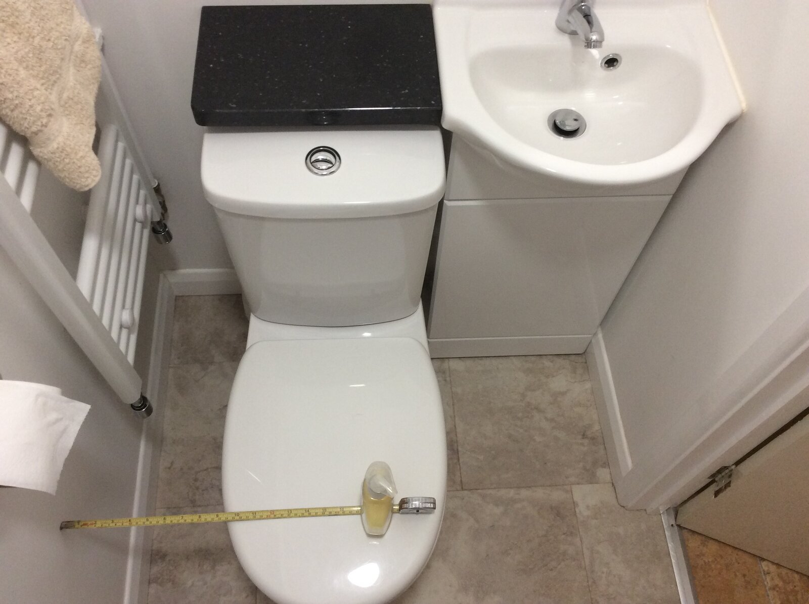

I've seen somewhere stated as 500mm min from toilet centreline to adjacent wall.
My en suite toilet (not just from centreline) is in a space of 570mm and is perfectly fit for purpose*. Utility is the issue- will it all work together when in use. If yes, then it fits!
*No-one has become wedged in there in 25 years!
