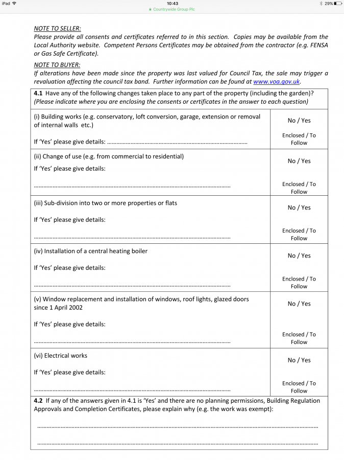

So it sounds like there may be a chance that some solicitors may use the word 'Any' when asking if I've carried out electrical work. If this were to happen it sounds like I either have the choice to deny carrying out any electrical work myself (which I think is being suggested by some people) or to be honest and state yes, but, "None in respect of which Regulation 12 of the Building Regulations imposes a requirement".
If I take the first option it sounds like it will be hard to prove otherwise. I may be breaking the law but if I don't get caught could save myself certain amounts of hassle and extra cost. If I take the second option, I am adhering to the law but may leave myself open to demands by the buyer which may incur additional costs on my part but, would hopefully not be so sever that I would have to get any of the minor non notifiable work redone and certified by a qualified electrician? Does this stand even if I don't get the light circuit and Earth Fault Loop Impedance tested by a qualified electrician and therefor have failed to get a "certificate for all work within reason"?

There are a number of standard forms used, Law Society form TA6 asks "Has the property been rewired or had any electrical installation work carried out since 1 January 2005?" with tick boxes for Yes, No, Not known.
It then asks :
If Yes, please supply one of the following:
(a) a copy of the signed BS7671 Electrical Safety Certificate
(b) the installer’s Building Regulations Compliance Certificate
(c) the Building Control Completion Certificate
with tick boxes for Enclosed or To follow for each of those.
Basically it's not been revised since it was first written on the basis that all work should be accompanied by a certificate, and doesn't really cater for "yes I have this bunch of work that doesn't need certificates - you have a problem with that ?"
That's a POP to answer:
At which point any vendor would do well to consider whether any potential buyer who starts to get agitated about trivial electrical work is actually the sort of buyer who should be kicked into touch at the earliest opportunity.
