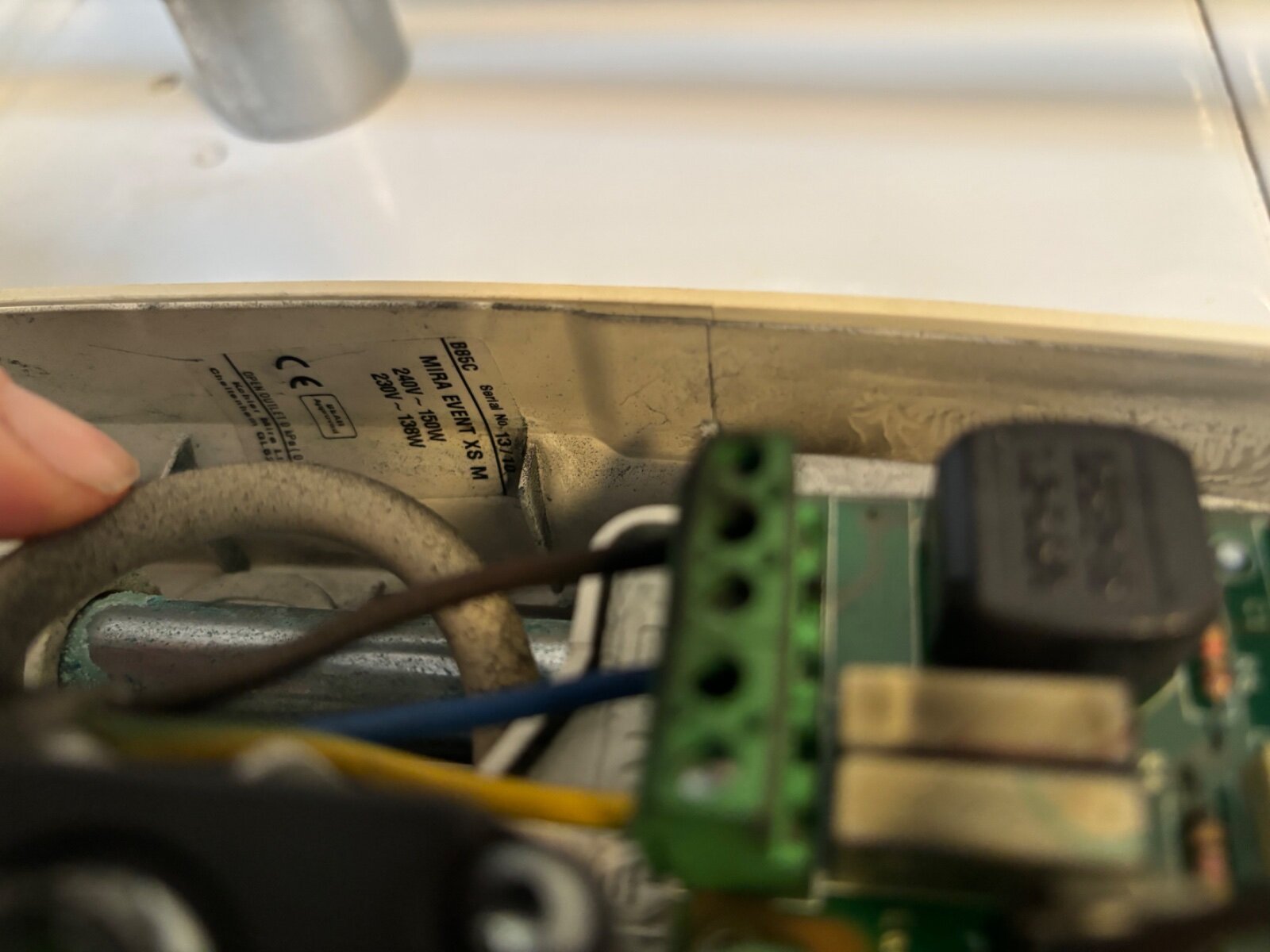

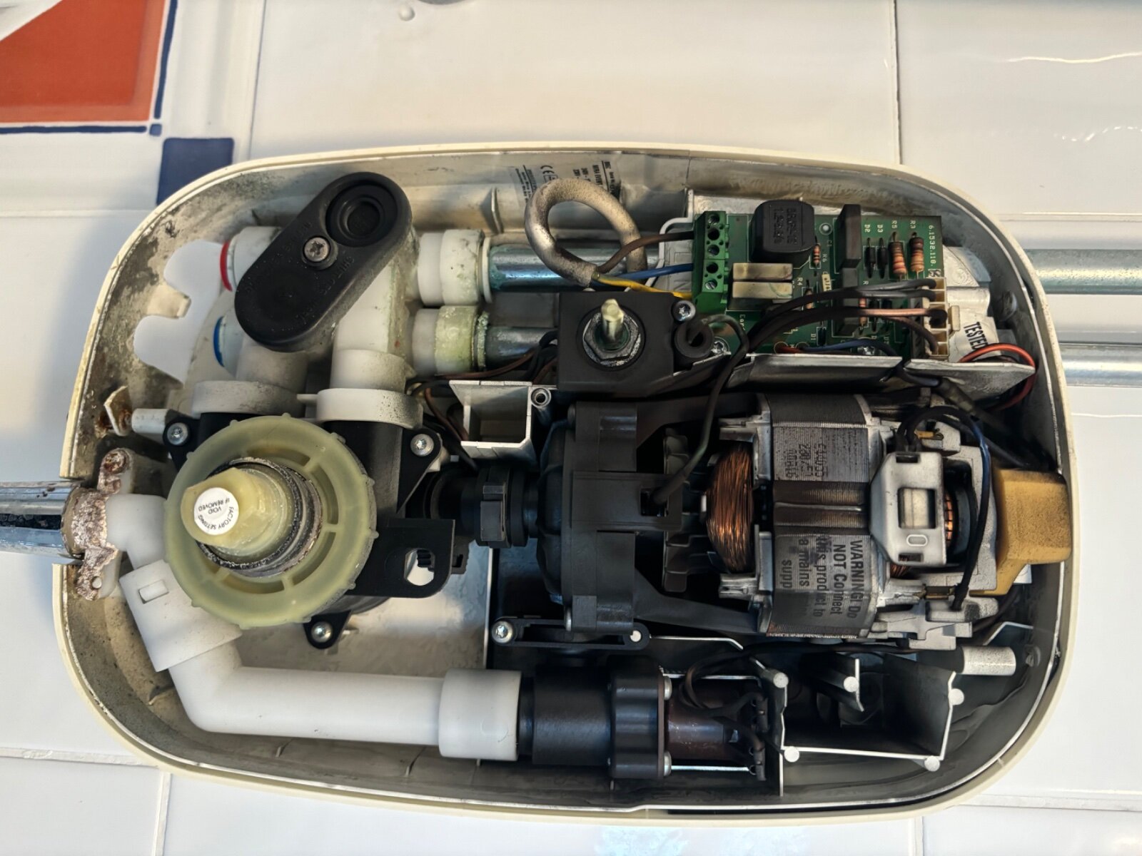

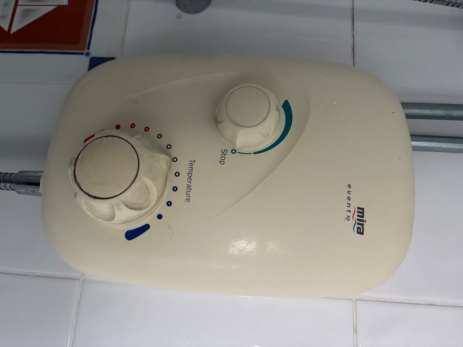

Hi
I’m thinking that my Mira Event XS M shower is due a replacement.
I believe that this type of shower is a thermostatic power shower?
Are these showers now mainly obsolete? as the only replacement I can find is a very basic looking shower from Screwfix. Preferably I’d like something a little modern and maybe black in colour.
As the mains cable is only 1.5mm flex I’m presuming this limits a replacement to 3kw?
Hoping to get a little advice on how to proceed.
Many thanks
*apologies for the sideways images
Ok.
It is.
I don't think obsolete is the right word.
Looks exactly the same as your old one.
Ok.
Thereabouts but not really relevant.
Well - without rewiring and replumbing you cannot have an instantaneous electric shower if that is what you have in mind.
No, but they were never big selling items, as they are only of use for the small number of properties that have a hot water cylinder supplied from a cold water cistern in the loft above, and that have people living there who don't want to install a separate pump next to that cylinder for whatever reasons.
