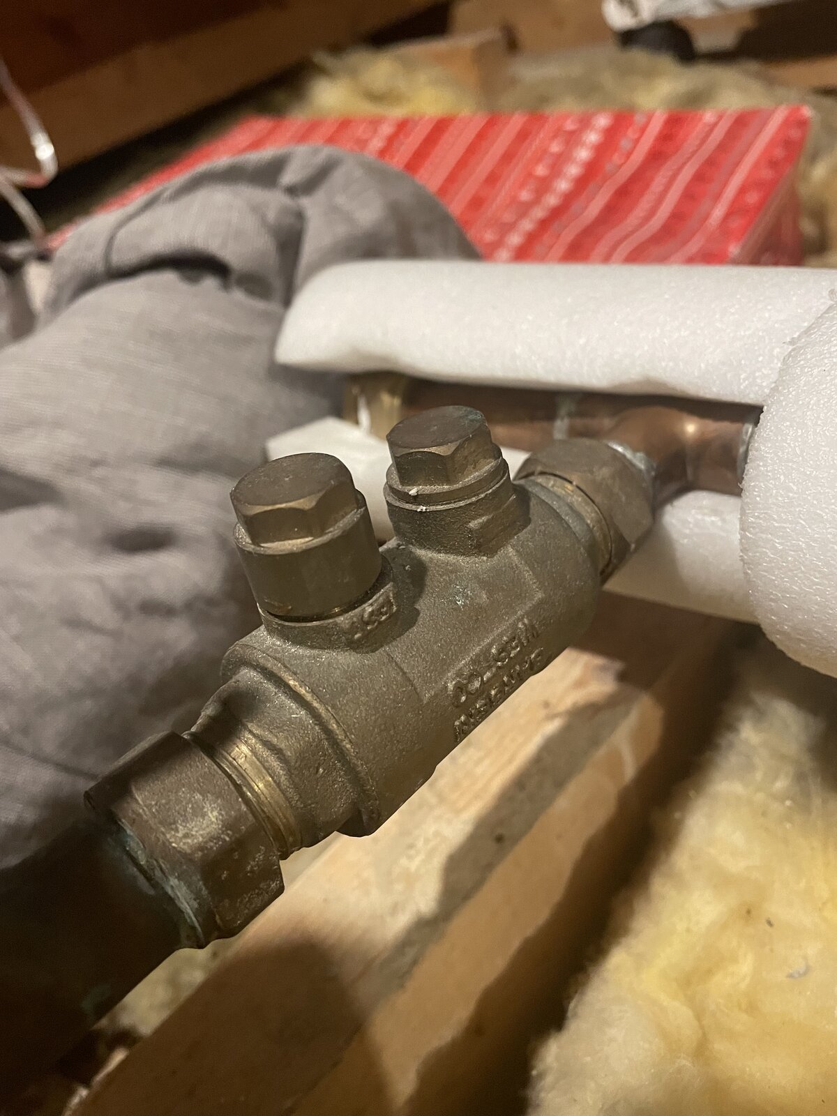

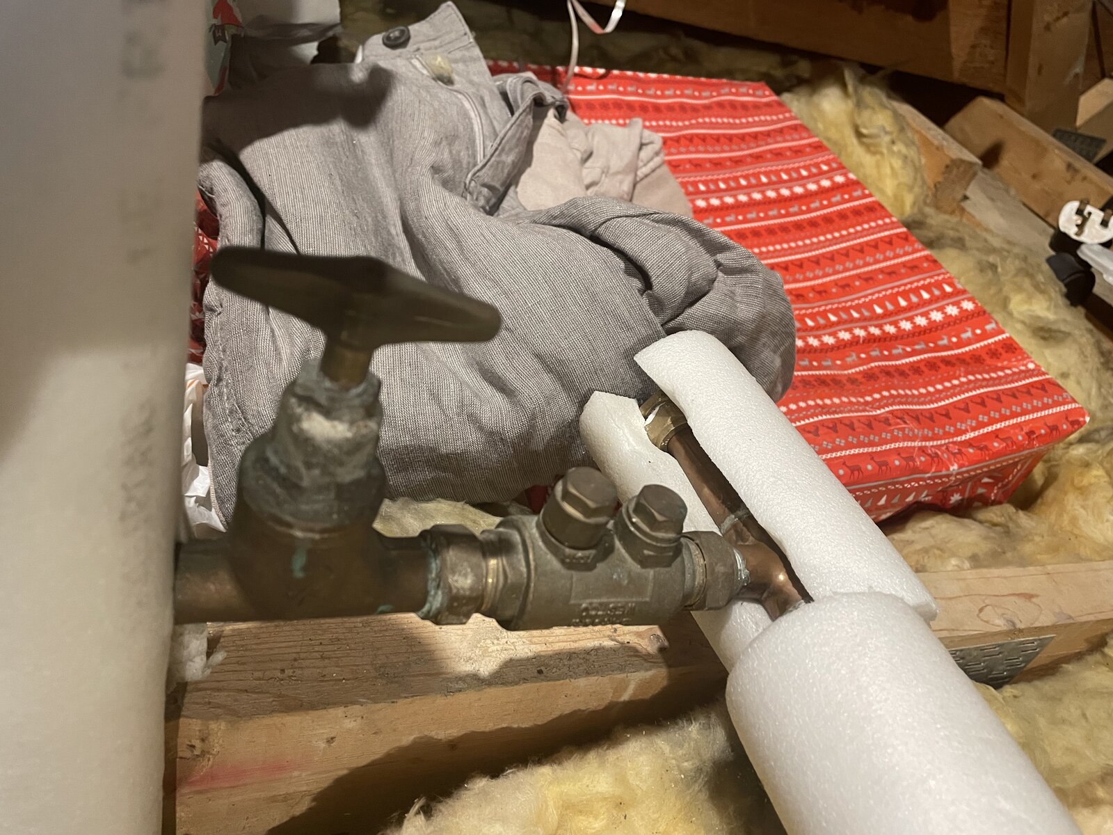

Okay so I’m significantly over this flow rate, so my actual mains feed isn’t the issue - it’s early morning so everything nice and cool. However could there be something (valve, stop-tap etc) that’s swelling in the heat perhaps that’s killing the feed to the shower? There is a stop tap in-line on the pipe in the loft that leads to the shower, and a strange fitting I’ve not seen before just after it that's possibly a reducer or something
Used to have a header tank/water cylinder - that’s all been removed since (can see at edge of insulation where it’s been capped off) - shower feed is off to the right side

Don't know what that is, check that the isol valve wheel goes ~ 3 full turns between shut and open, I would remove that fitting and just install a bit of pipe in its placee except that this device shows up something special. Is this supply just dedicated to the shower??
Yeah that’s what I’m thinking. Yep only the shower now the header tanks out of service. Thanks
It appears to be a "verifiable" temperature controller of some sort or other so just remove it, all electric showers can deal with water up to 28C.
