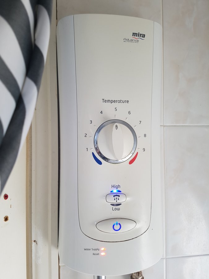

My Mira shower keeps resetting....i turn off the power supply and turn it back on and the red light shows and then the shower cuts out. Any ideas...its about 8-10 years old.

Tried taking hose and head off and ran ok from unit without resetting. Then when put hose back on it reset again.
I've just tried it again and the reset button comes on without the shower head on ....so it's not the head.
I don't think it's the hose now as the reset light comes on even when I disconnect it..
.where would the filter be found ???
Power off, water isolation valve off, case off, then use @newboy 's diagram to see where the filter is. It's a plastic nut that screws into the cold inlet valve, unscrew that and check the filter's clean.
On the pipework supplying the shower you need to find an isolator before attempting any repair (as well as isolating the electrical supply before it reaches the shower - at the consumer unit preferably)

In your pic, bottom right, it's is a plain screwdriver slot in the ISO valve. Insert and turn the screwdriver 90 deg until the slot is horizontal.
