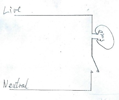

You could insert a switch in the Line or Neutral, but it must be placed in the line.
So the way that light switches are wired, the switch is physically in the Line half of the circuit (e.g. at 2 o'clock).
I was thinking that a switch physically in the Neutral half of the circuit (e.g. at 4 o'clock) would be connecting Line & Neutral.
What I think you are saying that by definition Line ends at one side of the load and Neutral starts at the other side of the load. Is that right?

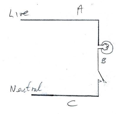

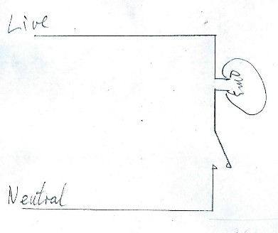

Thanks for trying to help. I think the problem here is that all of the electricians are used to expressing things in a certain way (nothing wrong with that, all trades have conventions and use language in a specific way) and when I used words/phrases to mean something different there was confusion.
As I said, I was thinking that a switch physically in the neutral half of the circuit would be connecting live & neutral, like this
In that diagram I was referring to the wire labelled B as live, in that if you held on to it and were earthed you would get a shock, but it seems that electricians would not refer to it in that fashion.

You should never switch the neutral, always the live. If a normal dwelling has switched neutrals something is very wrong.
