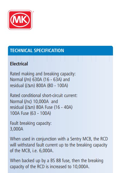

Well, a separate RCD can only break 63a or so?,I wonder what happens when there's a short to earth? The mcb has 0.4 seconds to react and can easily break your fault current but the rcd will be quicker to try. Will there be enough time to damage it? I guess the real breaking capacity is much higher than the rated current, is the 100a rating of a main switch the breaking current or the continuous current?
They (and, I presume) the relevant Standards) have thought of that. Taking MK Sentry RCDs as an example ....
Kind Regards, John
