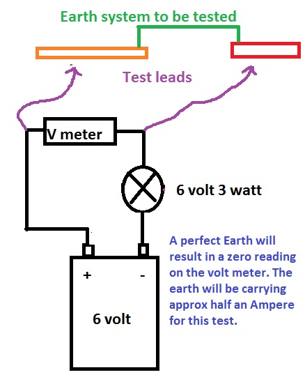

An old fashioned method of testing the integrity of an "earthing" system was to pass a current through the conductor and measure the volt drop along the "earthing system" being tested.
The crudest method uses a battery, torch bulb and a volt meter.

Often old methods are best, a battery and bulb and long wire to know good earth with power off. My father-in-law said to me I would never forgive myself if my child was injured or killed with an electric shock, so he pushed me to fit RCD's in the house, although he never fitted them to his own, they will not stop you getting a shock, but will limit the time to 40 mS and offer reasonable protection.

I’ve now tested the resistance of my cpc from CU, R2, to all metal fixtures, maximum reading of 0.7 ohms so very happy. Obviously don’t have the equipment to test the impedances but I think that satisfies me
As far as earth bonding goes resistance = impedance in real terms, the proper tester must use 200 mA at least for the test, but I only use it because I have one, I would be satisfied with a multi meter for my own house.
