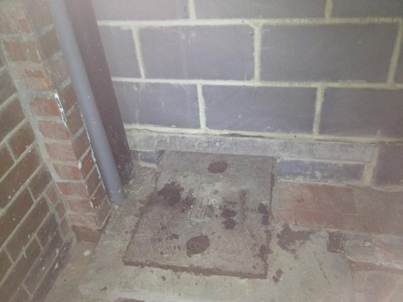

2) There are jobs which weren't on the original plan, namely the new extension roof (pitched), reconfiguration and replacement of kitchen appliance set up and installation of an additional wall leaf between the garage and extension (presumably to allow appropriate insulation, but has ended up partially covering a drain - see pic - access maintained by a low level lintel - no foundations but not load bearing).
The points under (2) above have not been inspected at all (confirmed by inspector). The sparky also didn't leave any sort of certification for the new light fittings and appliance installation.

Building control said the plans literally only covered removal of the wall so nothing else is technically covered. He noticed that the roof was being replaced so dropped the relevant standards round to the site but was never called back after that visit to inspect anything else.
He apparently wouldn't have looked at anything like the relocation of drainage for the new sink and watercooler/freezer, or the electrical installation.
The vendors are either playing dumb or were genuinely out of the loop as they don't even know if a separate electrician was involved in the work and certainly not if he was properly qualified or not. There is apparently no electrical certification available and they reckon there is no cert for the project at all as it was "not required - the inspector was satisfied with the inspections he had done".

I may be jumping to invalid conclusions that there are works which should have been notified, and the inspector won't commit to anything on the phone, but he defnitely thought the roof replacement should have been notified. A lay man's review of the regulations indicates to me that relocating plumbed features and adding a wall leaf should have been notified. The surveyor also couldn't confirm that the patio windows were safety glass. I wasn't too worried about that, but have since found out that the windows themselves are subject to the regs and were not notified!

What you have is a house that has had some walls built up next to it. The work, as it stands, is not in accordance with the building regulations (you should assume they are not until it can be demonstrated that they are).
You do not have a house with an extension and so you certainly should not pay for a house with an extension.
