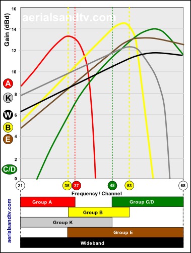

The Winter Hill muxes go down Ch. 21. If you have a group C/D aerial - something tuned for optimal reception from Ch.48 to Ch.68 - its reception will go lower, but by about Ch. 26 you're flogging a dead horse. For a home in a high field strength area, a bit of poorly shielded coax might be pulling in more signal for the lower frequency muxes than the aerial itself.
credit to aerials & TV for their graph.

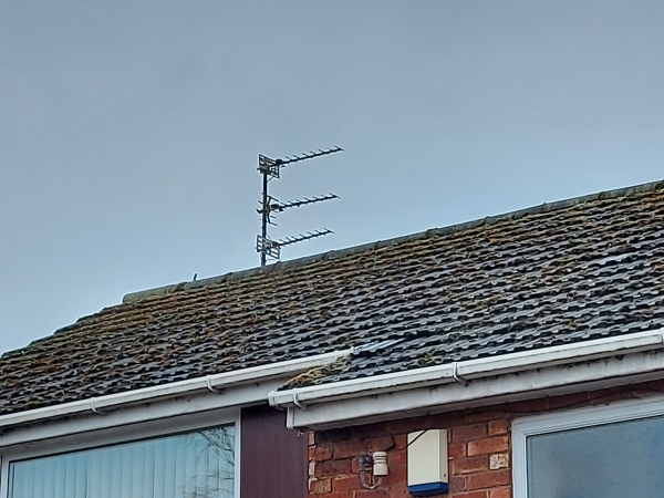

In all likelihood though, the aerial is probably one of those 'wideband high-gain' models. A Group W aerial. If that's right, then @Rodders53 is on the money about aerial and cable degradation.

Back in the 90s the Triax Unix 52 C/D was re-designated W as it went down rather well into A. But all widebands tend to be lower gain at A than C/D frequencies (except Log periodics and Grids), which was useful as cable losses are greater at the higher frequencies.

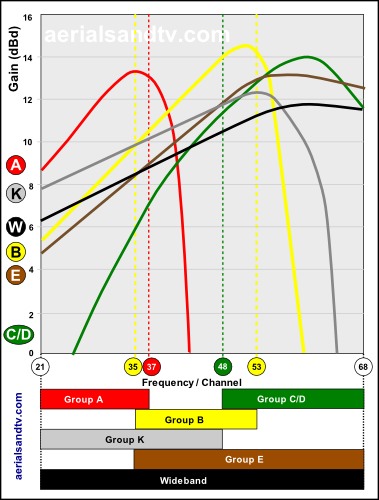

It's surprising the numbers of properties still using (or appearing to use) what looks like '80s era contract aerials. The boost in power post-DSO and the all-or-nothing nature of digital TV reception probably means if it ain't broke, don't fix it.
Loads of properties still have the old aerials up but switched to Sky or cable TV.

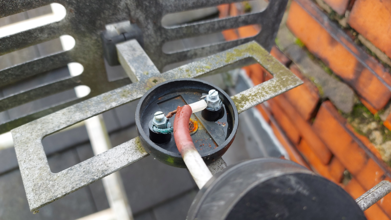

That could be as simple as the 'dodgy connection' that works some times and not others. I had a call out a few months ago like that. Reception would come and go. After checking all the stuff at ground level I got on the roof. When I came to the aerial cable connection, the whole thing was loose. A couple of wiggles and it came away, the whole thing. The steel bolt fixing had rusted through.
I guess depending how the wind blew the aerial, sometimes it would make a connection and other times it wouldn't. A new aerial and downlead sorted the issue.
