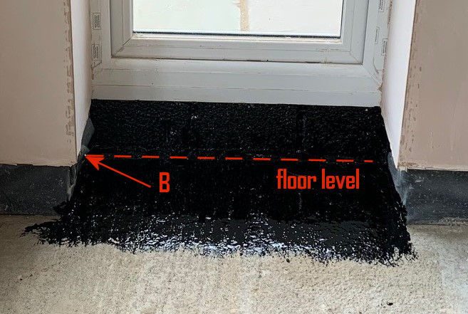

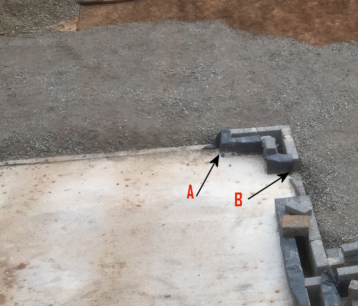

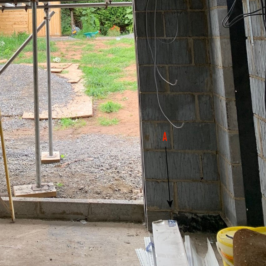

i asked you above in post#8 where exactly your DPM rises, and were the walls built off the specified "strip foundation" or the slab itself?

see pics
For A looks like half a block on slab then row of blocks, for patio door, on outer skin of blocks with no DPM in front
For B blocks built on outer skin of blocks for window with no DPM in front
Not sure what is under window or patio door (A)

Building control have visited. Not happy with height of patio. Initially wanted all patio taking up and dropping but have settled for a solution similar to Martin Hill's of strip to be cut out next to house, drain installed, membrane against wall and fill with decorative stone. They are not too bothered by lack of membrane inside as long as outside is controlled
